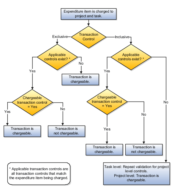

The following figure shows the steps that Oracle Fusion Project Costing uses to determine the chargeable status of an expenditure item.
			If the inclusive option is selected and applicable transaction controls don't exist, then the transaction isn't chargeable. If applicable controls exist, then the application checks whether the transaction controls allow charges.
If the exclusive option is selected and there are no applicable controls, then the transaction is chargeable. If applicable controls exist, then the application checks whether the transaction controls allow charges.
For both inclusive and exclusive transaction controls, a transaction is chargeable if the Chargeable check box is enabled for an applicable control. If the Chargeable check box isn't enabled, then the transaction isn't chargeable.
