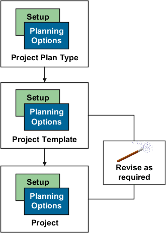

Create Project Plan Types
Create project plan types to define default information used for creating a project plan and capturing progress.
While creating a project plan type, you can associate one or more sets, specify plan, task, currency, rate, and progress settings, and select budget generation options.
Associate one project plan type to a project template. Projects created using the template inherit setup and planning option values. You can revise setup or planning options at each level to match specific planning requirements. The following figure shows how you can edit the setup or planning options at the project template or project level.
The following sections describe how to create project plan types.
