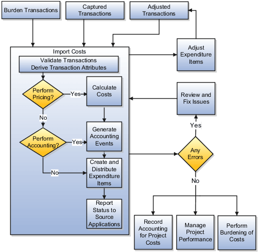

This flow chart explains the processing of project cost transactions.
Flowchart of processing project costs from internal and third-party applications.
