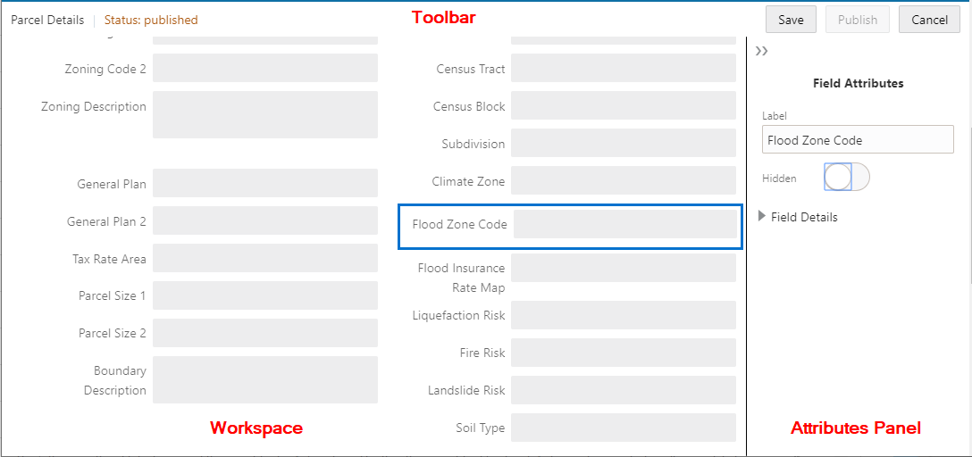

This example illustrates the user interface of the page edit mode. Details are in the surrounding text.
        When in page edit mode, the interface consists of these items:
Toolbar
Workspace
Attributes Panel
Using the Toolbar
The toolbar spans the top of the interface below the global header and displays the following information and controls.

Using the Workspace
The workspace displays the content of the page that you can modify. Select a field on the page to display its attributes in the Attributes panel.

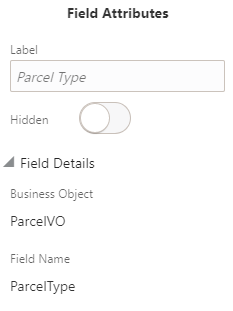

Using the Attributes Panel
The Attributes Panel contains the attributes you can modify for a selected page element, such as a field.
This example illustrates the Field Attributes panel when modifying existing pages. Details are in the surrounding text.
         You can view and set these field attributes:
|   Page Element  |
               Description  |
|   Label  |
               Use to modify the existing label for the page.
               Note: The length limit for modified field labels on existing pages is 100 characters.
               Note: Do not change the meaning of a field label in an attempt to use it to reflect a value different from its intended purpose. For example, don’t change “Flood Zone” to “School Zone.” Each field may have logic behind it, dependencies in workflow, dependencies related to fees, and so on. The ability to change field labels is intended to support minor changes in terminology.
|   Hidden  |
               Use to hide a field on the existing page. When the switch is on, the associated field is hidden.
               Note: Fields that are set to be required can’t be hidden.
|   Business Object  |
               The name of the database view object associated with the page.  |
|   Field Name  |
               The name of the field as it appears in the REST payload, which you can view using a describe command for the associated REST resource.  |
