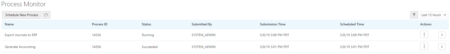

The Process Monitor enables users to initiate and manage processes for Oracle Public Sector Compliance and Regulation.
This example shows the Process Monitor page.

Managing Processes
Select Common > Process Monitor.
The Process Monitor page displays the following information for each process:
  • Name
  • Process ID
  • Status
  • Submitted By
  • Submission Time
  • Scheduled Time
Note: The Submission Time and Scheduled Time columns use the time zone specified in the user’s preferences, not the time zone for the agency.
Click Filter By to filter the displayed process information by Name, Process, and Submission Time.
