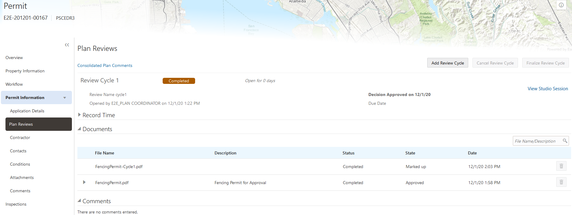

This example shows the Plan Reviews page for an electronic review.
Example of the Plan Reviews page for an electronic review

  1. Select Permits or Planning Applications on the Agency Springboard.
  2. Select a transaction record with a status of Plan Review.
  3. In the navigation panel, select Permit Information > Plan Reviews or Planning Application > Plan Reviews.
  4. In the Documents grid, expand the row for the document you want to review.
  5. Click the View More Details button for your row.
