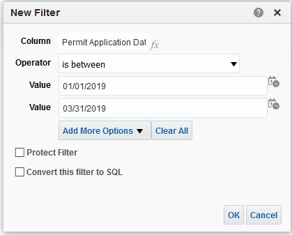

  3. You can filter Permit Application Date to see a specific date range. Edit the filter by clicking or hovering over the button next to its name.
  4. Select the filter to show only a specific date range and click OK.
    This figure illustrates choosing a filtering option to show only records in a specific date range.
    New Filter page

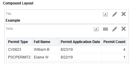

  5. Click Results. The Results tab shows your analysis at this point. Move back and forth from Criteria to Results at any time to see your analysis.
    This figure illustrates the results of a simple permit activity analysis from a subject area:
    Results of a simple permit activity analysis from a subject area

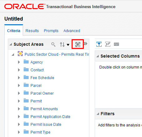

To add multiple subject areas to editing palettes:
  1. Create your analysis using a single subject area.
  2. In the Subject Areas section, click the Add / Remove Subject Areas icon.
    This shows the Add / Remove Subject Areas icon.
    Subject Areas section showing the Add / Remove Subject Areas icon
  3. Select or remove one or more standard or custom subject areas from this analysis by selecting or deselecting subject area. If you have created custom subject areas, they also appear in this list under the name you assigned to them.
