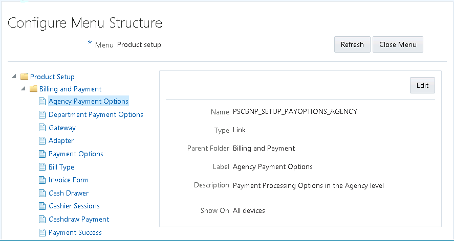

Working with Menus
To open a menu:
  1. Select Navigation > Menu Configurations.
  2. On the Configure Menu Structure page, select a menu from the Menu drop-down list.
  3. Click Open Menu.
To close a menu, click Close Menu.
To view changes to the menu structure, click Refresh.
Selecting a Menu Item
When working with menu items, you have a graphical representation of the structure on the left-hand side of the page, showing all the menu folders and menu links within the menu structure.
Select an item in the menu structure to view the details related to that menu item. Depending on the item selected, you have these options for configuring the menu.

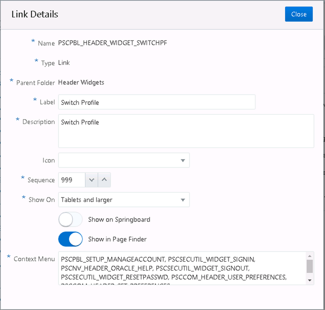

Configuring General Menu Item Properties
Menus contain menu items, which can be menu folders or menu links. Most of the properties you can view and set for menu folders and menu links are the same. Properties specific to a particular menu item type are noted below.
Link Details page

Context Menu
The edit box appears only for menu items that display a menu, such as:
  • Switch Profile
  • Actions
This edit box enables you to manage content links that appear on a drop-down list for the UI widget.
Enter a comma-separated list of menu link names. For example:
PSCPBL_SETUP_MANAGEACCOUNT, PSCSECUTIL_WIDGET_SIGNIN, PSCNV_HEADER_ORACLE_HELP,
The menu link names added to the list appear in the list for that page control or widget.
Note: Menu links that can group other menu links, such as the I Want To links, have similar edit boxes where you can point to menu items, named Content Link, Guided Process Actions, and so on.

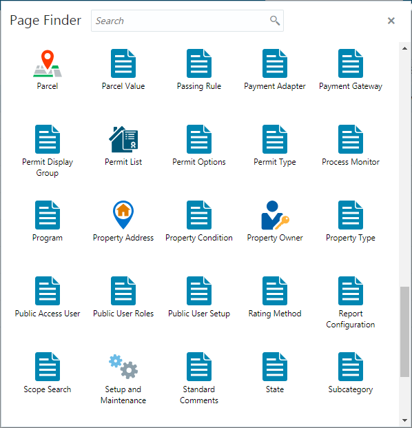

Using the Page Finder
This topic provides an overview of the navigation feature named page finder, and it describes how to use its features.
The Page Finder is a navigation feature an agency user accesses by clicking the Page Finder button in the header.
Page Finder icon
The Page Finder displays icons:
  • For all the pages to which a user has access. Users can click the icon to navigate directly to the page.
  • In alphabetical order.
  • In a “flattened” format, meaning each page link appears on its own — not within the menu folder/menu item hierarchy like you see in the Navigator menu. The Page Finder does not display menu folders.
This example illustrates the Page Finder interface with a description surrounding the image.
Page Finder default display showing links to all pages to which a user has access.
Note: The system does not display the Page Finder on smartphones (small form factor devices).
Note: The screen size and/or browser window size determines the number of icons in each row, displaying a maximum of five icons across with a minimum of four.
Note: The Page Finder is available only for agency users, not for public users.

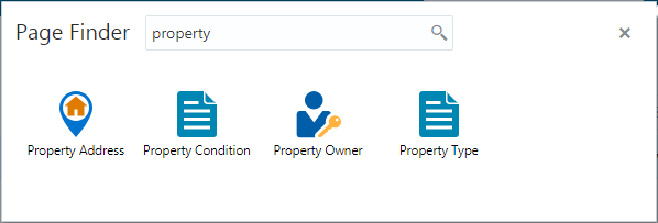

Searching within the Page Finder
Depending on the number of pages to which a user has access, the Page Finder may contain numerous icons within it. To find icons in the Page Finder:
  • Use the scroll bar on the right-hand side of the Page Finder (when displayed).
  • Type the full or partial name of the page into the Search field at the top of the Page Finder to reduce the number of page links displayed.
Page Finder displaying only links meeting search box criteria.

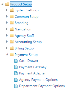

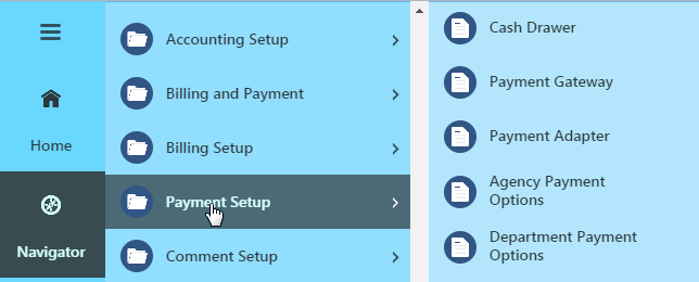

Viewing the Menu Structure in the Navigator
This topic describes how the structure in the menu definition is represented in the navigation feature named the Navigator.
The Navigator menu, displays when the user clicks the Navigation button in the global header.
The Navigator menu displays the menu content in the same hierarchy defined for menu folders and menu items in the menu structure displayed in the Configure Menu Structure page.
The following example illustrates menu folders containing menu items in the Configure Menu Structure page with description surrounding the image.
Example: Menu folder containing a collection of menu items.
At runtime, the Navigator displays the menu items within the menu folder as defined on the Configure Menu Structure page.
Example: Menu items appearing within a menu folder at runtime in the Navigator in same hierarchy as defined at design time.

  2. On the Configure Menu Structure page, select Products from the Menu drop-down list.
  3. Click Open Menu.
  4. Locate the Header Widgets folder or Footer Widgets folder, depending if you are modifying the header or the footer navigation widgets.
  5. Select the menu item you want to modify in either the Header Widgets folder or the Footer Widgets folder.
    For example, select the Switch Profile menu item in the Header Widgets folder.
  6. Click Edit.
  7. In the Context Menu attribute, add a comma, and enter the name content reference associated with link you want to add to the current link list.
    For example, to add the My Account link, add the content reference name PSC_MY_ACCOUNT.
  8. Save your changes.
  9. Confirm the link appears in the related link list.
    Example showing the My Account link added to the Quick Links related link list

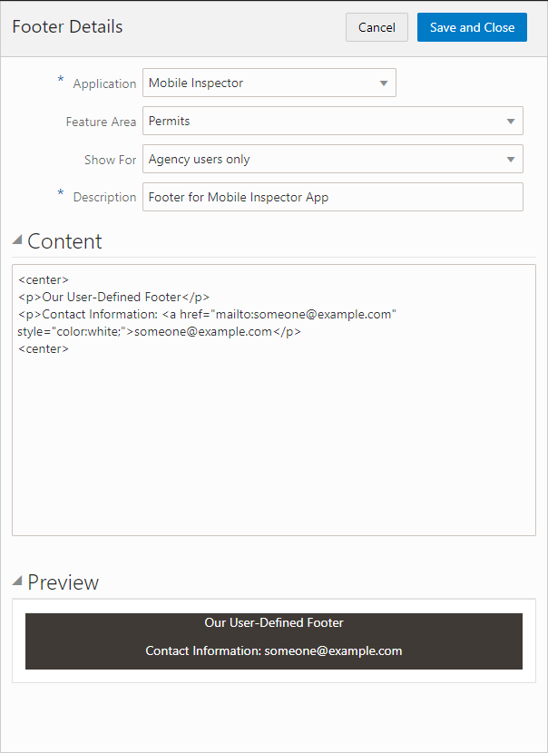

Creating a Free-Form Footer
To create a free-form footer:
  1. Select Navigation > Footer Configurations.
  2. On the Configure Footers page click Add.
    This launches the Footer Details page.
  3. For Application, select how the user accesses the page where the footer will be displayed, as in through the browser or by a mobile application. Options are:
    • Default: Displays for any user accessing the website from a browser, which could be running on a desktop, laptop, or mobile device. The user enters a URL or clicks a link to access the site.
    • Mobile Inspector: Displays for any user accessing the website using the Oracle Inspector mobile application installed on a mobile device.
    • Mobile Code Officer: Displays for any user accessing the website using the Code Officer mobile application installed on a mobile device.
    • Code Enforcement: Displays for any user accessing the Code Enforcement offering.
    Note: You can define only one footer for each application.
  4. For Feature Area, select the main feature to which the footer applies, such as Permits, Business Licenses, and so on.
  5. For Description, enter text to describe to other members of the implementation team the purpose of the footer definition.
  6. In the Content edit box, add your footer HTML.
    Your HTML needs to include all the required HTML elements with the proper links to images, CSS styles, and so on. Any content you enter will be displayed as is inside the <footer> element at the bottom of the page. It is assumed you already have the required HTML and styles in your agency website that you can copy into the Content edit box.
    Note: If you add any JavaScript to the footer content in addition to HTML and CSS, the Public Sector Compliance and Regulation application will run the JavaScript. Make sure you have addressed any JavaScript security issues related to any content you enter. Using any of the delivered CSS or JavaScript APIs is not supported.
  7. After adding your HTML content, tab out of the Content field and click Preview to display a preview of your footer.
  8. Click Save and Close.
    Note: As soon as you click Save and Close, your footer becomes the new footer for the current site. Make sure to use the preview feature as much as possible while you add the HTML for your footer.
Example: Free-Form Footer Example
This example illustrates how you use the Footer Details page to select where your free-form footer appears, add custom HTML, and preview the footer.
Footer Details page
