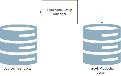

For example, you set up your initial configuration of the Public Sector Licensing and Permittings offerings in the test environment, which is your source system. Then, after thorough testing and verification, you move the setup and configuration data from your test environment to the target environment, which is your production system.
You use the Fusion Applications Functional Setup Manager to perform these migration tasks.
This example illustrates that you use Functional Setup Manager to migrate data between your test and your production environment.
This example illustrates Functional Setup Manager in relation to a test and production environment. Details are in the surrounding text.
Use Functional Setup Manager to migrate data between test and production environments.

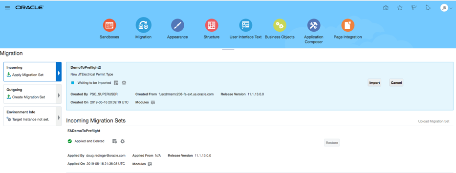

  7. Select the Outgoing tile and create an outgoing migration set to export to your production environment.
    When creating a configuration set, the utility compares differences between source and target, and determines the metadata that needs to be exported to the target system. When the process is complete, the resulting migration set is downloaded in the form of a downloadable jar file.
  8. After finishing the creation and migration of the outgoing migration set, sign on to the production system (the target system), and complete the steps for applying the incoming migration set.
This example illustrates an incoming configuration set.
Incoming configuration set during migration
For more information on these steps, refer to Oracle Applications Cloud documentation: Configuring and Extending Applications.

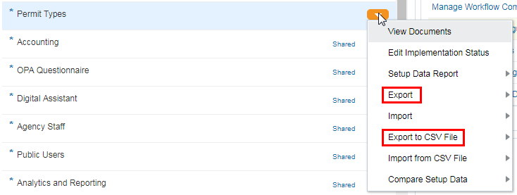

After you have completed migrating the configuration set on the source system, you then export the remaining transaction type data using the Functional Setup Manager options for the functional area or the entire offering.
Note: You can export and import at the functional area-level by selecting the Actions button for the functional area or at the entire offering level by selecting the Actions button at the top right.
This example illustrates using the functional area export options.
Using FSM functional area export features.
After exporting from the test system, you then sign on to the production system and import the corresponding business object data.
When you export business object data, you have the option to select only those business objects that you utilize. For example, if you are not using application groups, you could deselect Manage Application Groups from the Business Objects list.
The objects you export will be in the form of a downloadable jar file.
