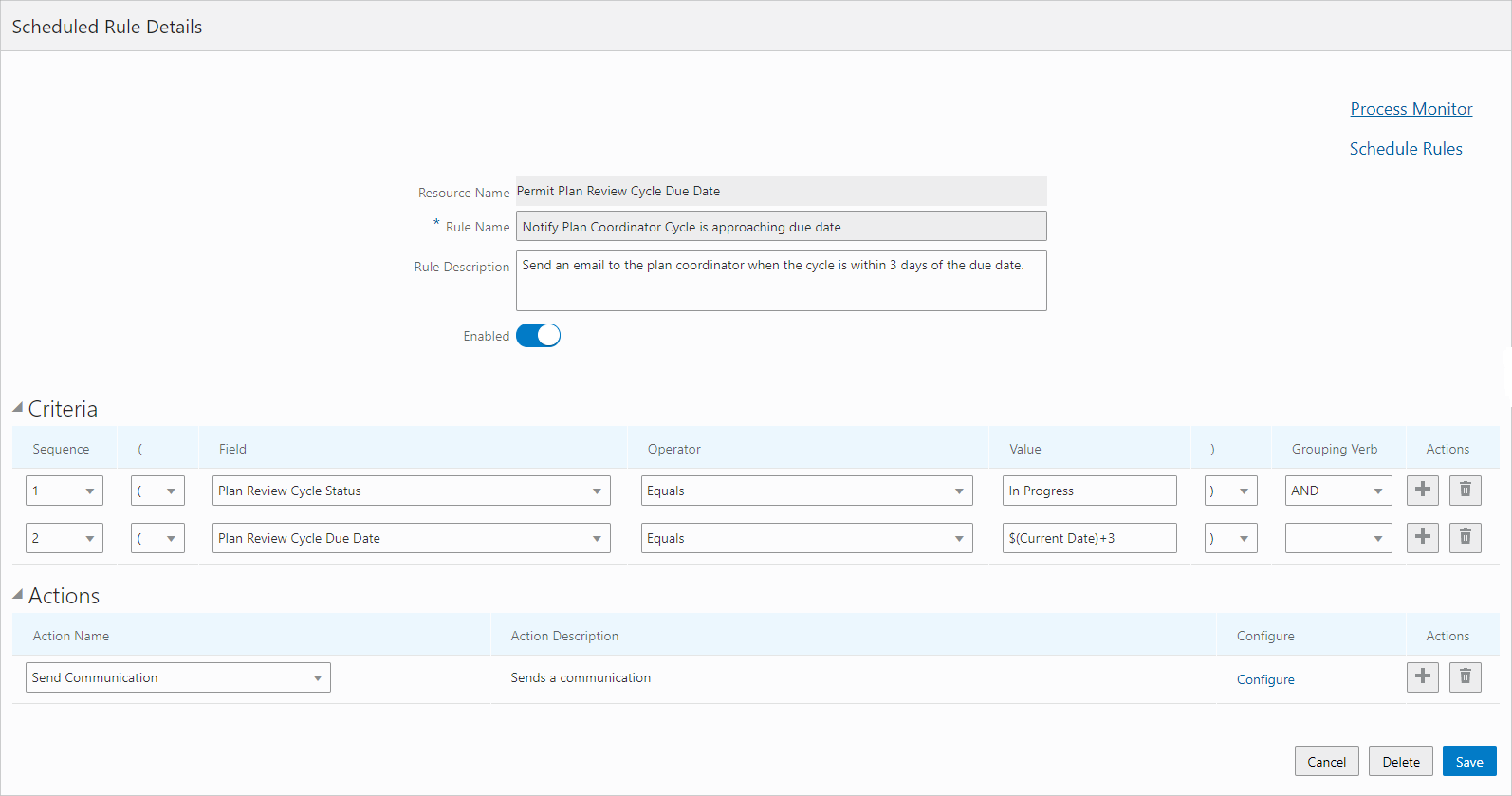

For example:
Scheduled Rule Details page
