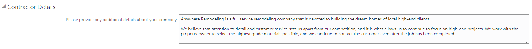

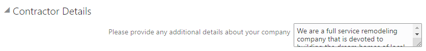

Full Width
Expand the Display section to view the Full Width switch.
Increases the visible area of certain field types so that users can view the content for fields containing larger amounts of information more easily.
For more information, see the section below titled "Increasing the Display Area for Field Content."

This example illustrates a Text area field type displaying the default amount of visible space.
Full Width option not enabled
Use the Full Width and Rows field attributes to expand the display size of certain field types.
This example illustrates the Full Width and Rows display options. Details are in the surrounding text.
Full Width and Rows set

This example illustrates a rich text field type with the Full Width option enabled and the Rows value set to 5 to display more field content for users.
Full Width and Rows options enabled
