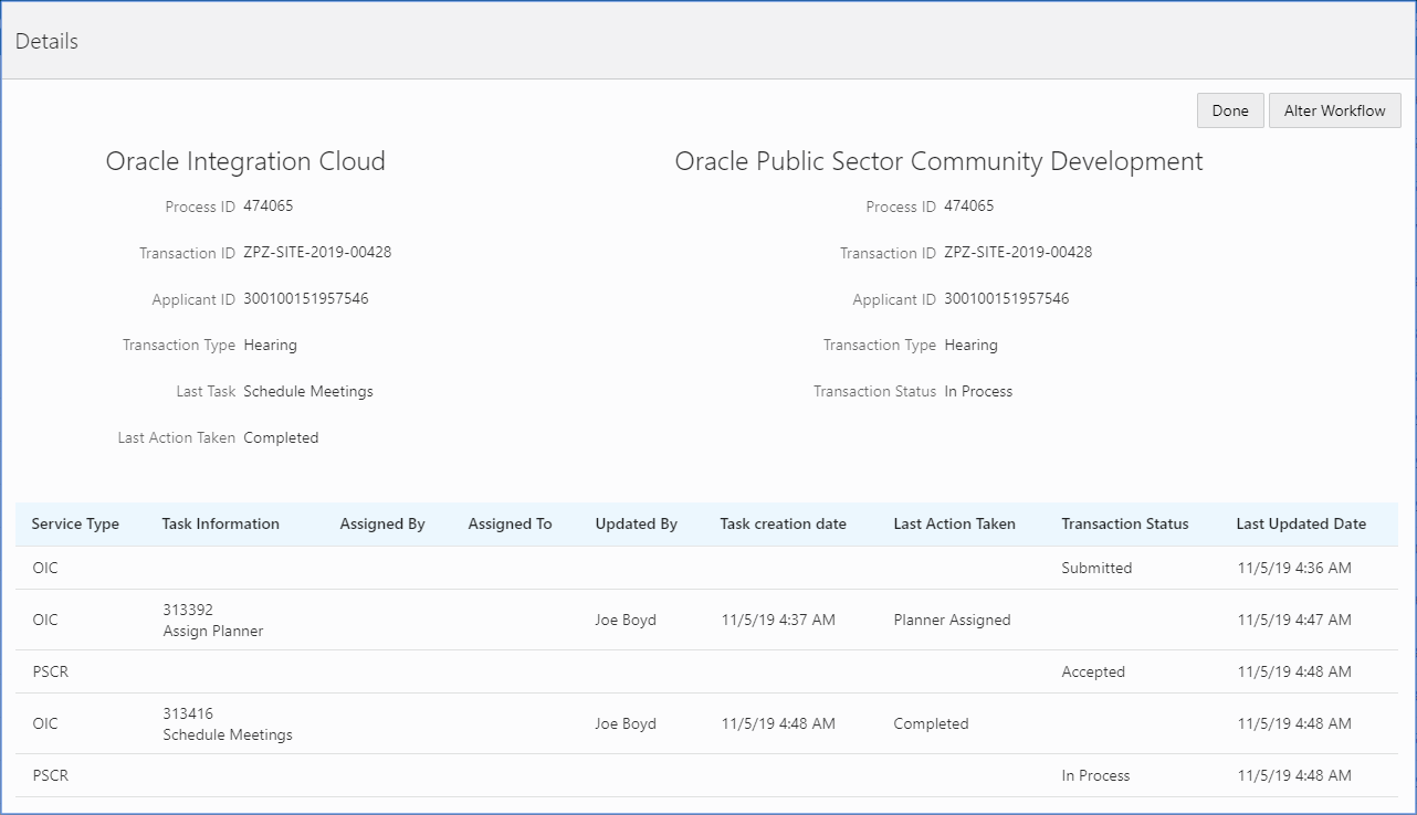

Using the Details Page
Use the Details page to drill into a specific transaction and take action to resolve any discrepancies between the OIC and Public Sector Licensing and Permitting systems. The Details page contains the transaction history in sequential order between the two systems for a given transaction.
Access the Details page by clicking on any row in the grid on the Manage Process Instances page.
This example illustrates sample data as it would appear in the Details page.
Inconsistent Instances Details page
At the top of the Details page the Oracle Integration Cloud and the Oracle Public Sector Compliance and Regulation sections display a high-level view of the current status for that transaction in the respective systems.
Depending on the information displayed, you may elect to perform different actions, which appear as buttons on the right hand side of the Details page.
Details page actions

Page elements on the Details page high-level section.
Page Element
Description
Process ID
The workflow instance ID assigned for a specific transaction by the OIC system when that transaction is submitted.
Transaction ID
The unique ID of a specific submitted transaction, which is based on the auto number rule.
Applicant ID
The unique ID of the applicant who submitted the transaction intake form.
Transaction Type
The transaction type as defined on the Transaction Type page. For example, for a permit this will be the Permit Type value.
Last Task
The last task in the workflow process definition that the transaction has reached. (Applies only to the OIC system.)
Last Action Taken
The action taken on the last task. (Applies only to the OIC system.)
Transaction Status
The current status of the transaction reflected in the Public Sector Licensing and Permitting system, such as In Process, Accepted, and so on.
Page elements on the Details page grid section.
Page Element
Description
Service Type
Indicates what service handled the request. Options are:
  • Public Sector Licensing and Permitting: indicates the Public Sector system.
  • OIC: indicates the Oracle Integration Cloud instance.
Task Information
The task information associated with the task defined in the workflow process definition.
Assigned By
The user name of the individual to who assigned the current task to the assignee.
Assigned To
The user name of the individual to whom the current task is assigned.
Updated By
The user name of the individual who updated the task.
Task Creation Date
The date and time the task in the workflow process definition was initiated for the current transaction.
Last Action Taken
The last action taken as reflected in the OIC system.
Transaction Status
The status of the transaction reflected in the Public Sector Licensing and Permitting system.
Last Updated Date
The date and time when the transaction was last updated.
