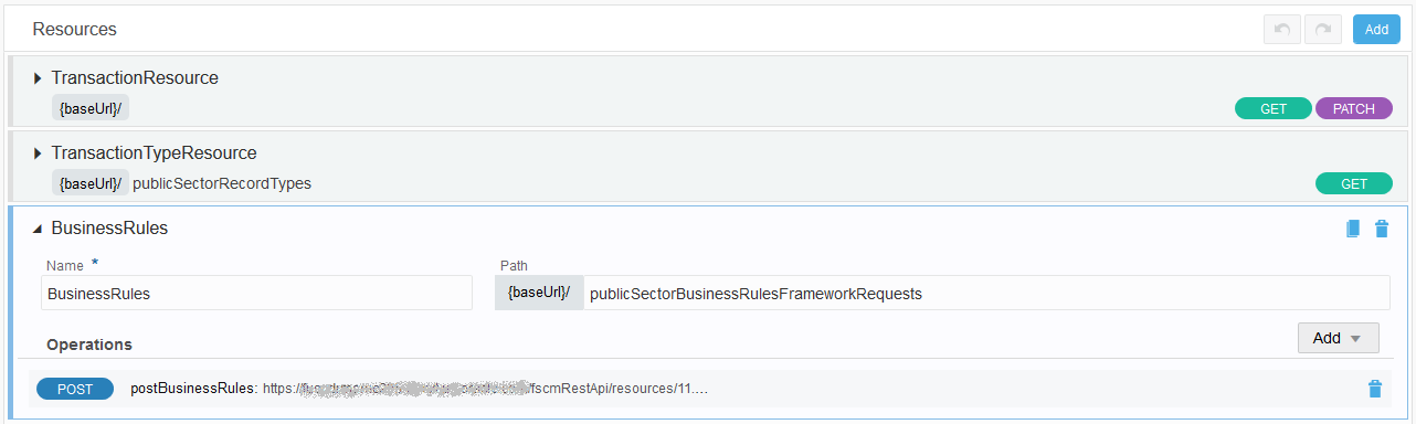

Open the Transaction Connector.
In the Resources box, click Add.
Expand the added resource and enter these values:
List of values to add for a new integration name and path.
Page Element
Description
Value
Name
The name of the integration or connector. You can enter a custom name as needed.
BusinessRules
Path
The name of the REST resource you intend to call.
publicSectorBusinessRulesFrameworkRequests
This example illustrates adding a Business Rules resource.
On the new resource, click Add, and select the appropriate operation.
In this case, select POST operation.

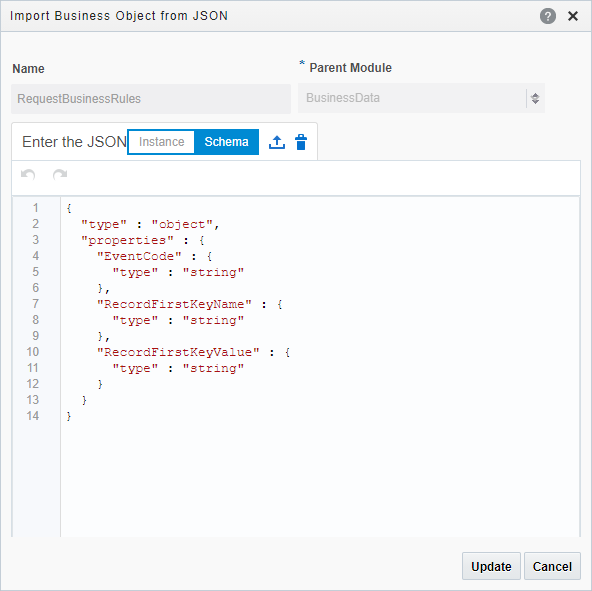

In the Response and Request section, select the Request tab, and click Create business object under the Body field to open the Import Business Object from JSON dialog box.
For Name enter a recognizable name for the request, such as RequestBusinessRules.
In the Enter the JSON edit box, select Schema.
Copy and paste the following JSON.
{ "type" : "object", "properties" : { "EventCode" : { "type" : "string" }, "RecordFirstKeyName" : { "type" : "string" }, "RecordFirstKeyValue" : { "type" : "string" } } }This example illustrates the request JSON.
Click Import.

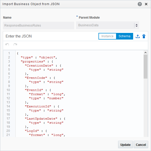

Configure the JSON Response.
For Name enter a recognizable name for the response, such as ResponseBusinessRules.
{ "type" : "object", "properties" : { "CreationDate" : { "type" : "string" }, "EventCode" : { "type" : "string" }, "EventId" : { "format" : "long", "type" : "number" }, "ExecutionId" : { "type" : "string" }, "LastUpdateDate" : { "type" : "string" }, "LogId" : { "format" : "long", "type" : "number" }, "NoRules" : { "type" : "string" }, "RecordFifthKeyName" : { "type" : null }, "RecordFifthKeyValue" : { "type" : null }, "RecordFirstKeyName" : { "type" : "string" }, "RecordFirstKeyValue" : { "type" : "string" }, "RecordFourthKeyName" : { "type" : null }, "RecordFourthKeyValue" : { "type" : null }, "RecordIdentifier" : { "type" : null }, "RecordSecondKeyName" : { "type" : null }, "RecordSecondKeyValue" : { "type" : null }, "RecordSubIdentifier" : { "type" : null }, "RecordThirdKeyName" : { "type" : null }, "RecordThirdKeyValue" : { "type" : null }, "ResourceId" : { "format" : "long", "type" : "number" }, "StopProcess" : { "type" : "string" } }This example illustrates the response JSON.
Click Import.
Close the Import Business Object from JSON dialog box.

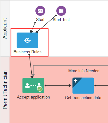

Add a task to the process definition to incorporate the integration.
Open the process definition.
In the BPMN palette, expand the Integrations section, and drag your integration onto the process definition in the desired location and update the connectors as needed.
This example illustrates adding the Business Rules integration to a process definition.

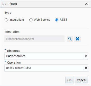

Confirm the integration is referencing the correct operation.
Select the task and click Open Properties.
Select Implementation, General and then click Configure for the Service Call.
This example illustrates the integration step referencing the REST operation.

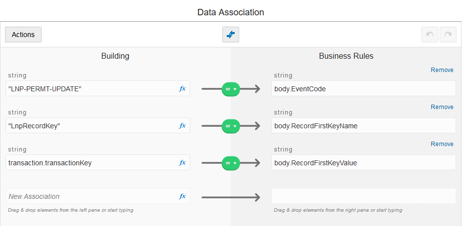

Configure data associations.
Select your integration task and select Open Data Association.
On the Data Association page, select the Input tab.
Map the following process definition data attributes to your Business Rules integration attributes, and click Apply and Save.
Data associations for the business rules integration.
Data Object
Integration
"LNP-PERMT-UPDATE"
or
"PZ-PLANNING-UPDATE"
Enter these values manually, depending on whether this process definition is being used for Permits or Planning and Zoning.
body.EventCode
"LnpRecordKey"
Enter this value manually.
body.RecordFirstKeyName
transaction.transactionKey
body.RecordFirstKeyValue
This example illustrates that data associations between the transaction and the business rules integration.
