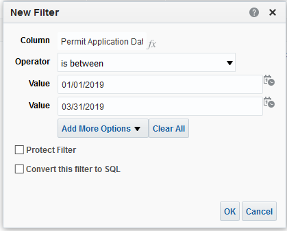

You can filter Permit Application Date to see a specific date range. Edit the filter by clicking or hovering over the button next to its name.
Select the filter to show only a specific date range and click OK.
This figure illustrates choosing a filtering option to show only records in a specific date range.

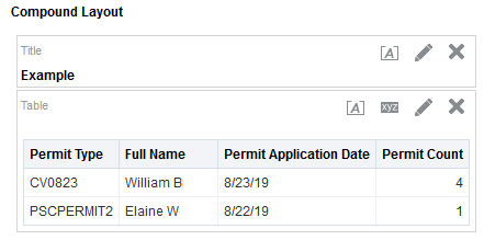

Click Results. The Results tab shows your analysis at this point. Move back and forth from Criteria to Results at any time to see your analysis.
This figure illustrates the results of a simple permit activity analysis from a subject area:
