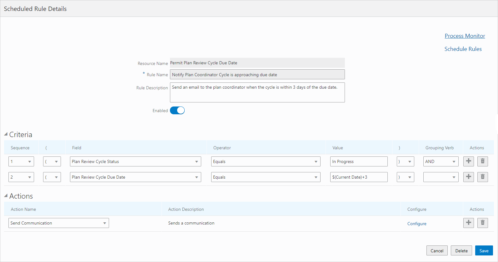

On the Business Rules Framework landing page, select the Scheduled Rules tile.
On the Scheduled Rules page, click Add.
At the top of the Scheduled Rule Details page, enter the following information.
Page Control
Description
Resource
Select the resource (business object) that contains the attributes you intend to evaluate and compare in your criteria.
With the scheduled rules, you select the business object directly as opposed to selecting the defined events for an offering. The "event" which triggers the rule for a scheduled rule is when the Enterprise Scheduler Service runs the rule according to the defined schedule.
Note: The Resource drop-down list displays the current list of resources that you can use for scheduled rules.Rule Name
Enter the name for your rule.
Rule Description
Enter a description to help other implementation team members understand the purpose of the rule.
Enabled
Turn on to enable the rule. Turn off to disable it.
Enter the criteria for your rule.
For more information on defining rule criteria, see Setting Up Business Rule Criteria.
Select the action for your rule.
Depending on the resource, the selection of actions varies. The list displays the actions applicable and supported for the selected resource.
For example:
