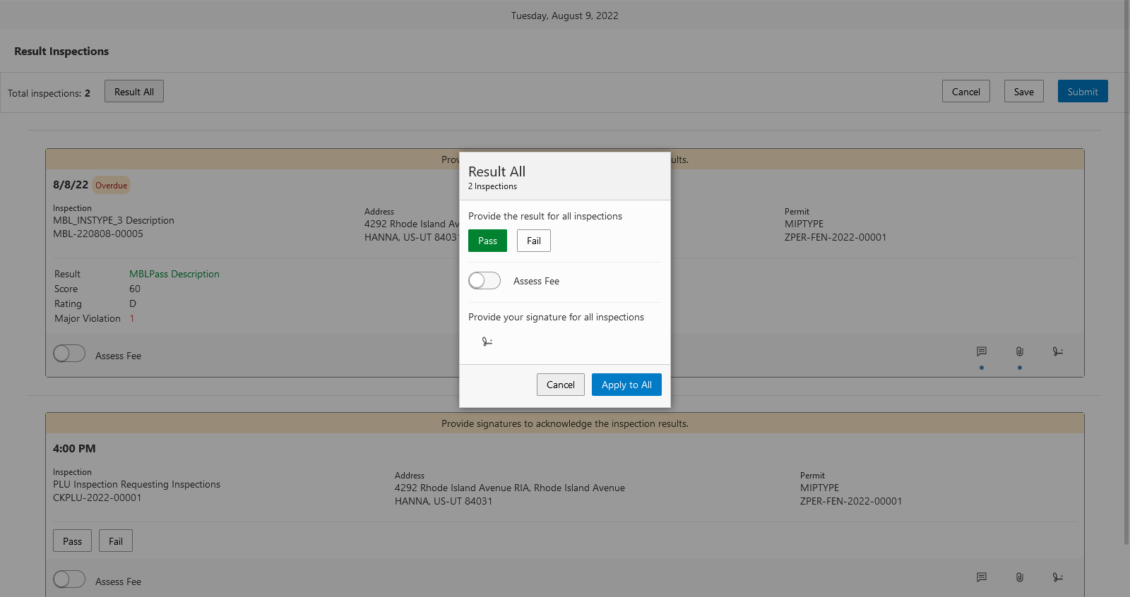

View the inspections you've selected on the Result Inspections page. Here you have a choice:
You can complete the result for each inspection on the Result Inspections page directly without going into each individual inspection. In this case, you can provide a different result for each inspection. You can also provide comments, attachments, and signatures, and turn on the assess fee option.
You can apply the same result, inspector signature, and assess fee option to all of the selected inspections at one time by clicking Result All. However, the result you select here will not override the system-calculated result for inspections using the scoring method.
This example illustrates the Result All modal page where you select the results that you want to apply to all of the selected inspections.
This table describes the elements on the Result Inspections page and on the Result All modal page that appears when you click Result All.
Elements on the Result Inspections page and Result All modal page
Page Element Description Result
Depending on the method used to calculate the results, the system may automatically calculate the final result based on checklist results or you can select a passing or failing result.
On the Result All modal page, you can select a passing or failing result that is applied to all of the inspections on the Result Inspections page. This option overwrites any existing results that have been calculated, but will not override the system-calculated result for inspections using the scoring method.
Assess Fee
Turn on the Assess Fee switch to indicate that a fee should be assessed. If fee assessment is configured by your agency, the system calculates the fee and charges it back to the permit applicant when you submit the inspection. For more information, see the "Assessing Fees" section in this topic.
The switch on the Result All modal page applies fee assessment to all of the inspections on the Result Inspections page.
Click the Add Signatures icon on the Result Inspections page to enter Inspector, Contractor, or Property Owner signatures. You must also add the names of contractors and property owners when they add their signatures. Click Show Signatures, which is the same icon displayed with a dot under it, to show the added signatures.
You can provide only the inspector signature for all inspections on the Result Inspections page using the Result All modal page.
Click the Add Comments icon to enter comments. Click the same icon with a dot under it to show the added comments. You can't add comments on the Result All modal page.
Click to add attachments. Click the same icon with a dot under it to show the added attachments. You can't add attachments on the Result All modal page.
Click Submit. You must submit the results and inspection information that you provided on the Result Inspections page or Result All modal page to complete the inspection.
