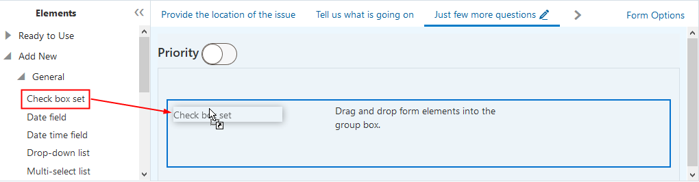

You can drag and drop these form elements into a drop zone:
User-defined fields
Group boxes
This example illustrates dragging and dropping a user-defined field type from the Elements panel into the drop zone.
The drop zone itself is a group box into which you can drag user-defined fields and other group boxes if needed.
Working with User-Defined Fields
You can drag and drop user-defined fields directly into the drop zone, or you can add group boxes to the drop zone and drag and drop user-defined fields into the group boxes.
To add a user defined field to the drop zone:
Expand the Add New list.
Expand the General list.
Select the desired field type by clicking and holding.
Drag and drop the field type onto the drop zone.

Expand the Add New list in the Elements panel.
In the General list, select Switch, and drag and drop it in the drop zone.
This example illustrates dragging and dropping a field type into the drop zone.

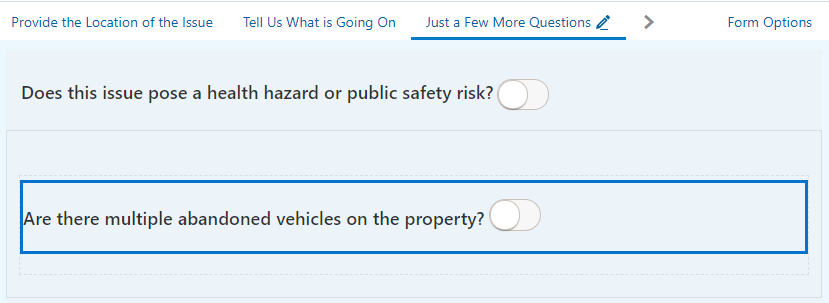

Select the switch, and observe the attributes you can configure for that field in the Field Attributes panel on the right.
Update the Label value.
For example Are there multiple abandoned vehicles on the property?
This example illustrates setting the label attribute.
Click Save.
Result:
This example illustrates a user-defined field added to the drop zone of an issue subtype form layout.
