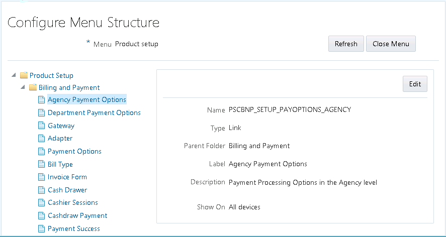

Working with Menus
To open a menu:
Select
On the Configure Menu Structure page, select a menu from the Menu drop-down list.
Click Open Menu.
To close a menu, click Close Menu.
To view changes to the menu structure, click Refresh.
Selecting a Menu Item
When working with menu items, you have a graphical representation of the structure on the left-hand side of the page, showing all the menu folders and menu links within the menu structure.
Select an item in the menu structure to view the details related to that menu item. Depending on the item selected, you have these options for configuring the menu.

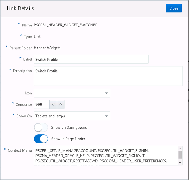

Configuring General Menu Item Properties
Menus contain menu items, which can be menu folders or menu links. Most of the properties you can view and set for menu folders and menu links are the same. Properties specific to a particular menu item type are noted below.
Page Elements |
Description |
Name |
Identifies the name of the menu item, as it is identified within the application. You cannot change this value. |
Type |
Indicates the type of menu item, which can be: root folder, folder, or link. |
Feature Area |
Indicates the feature area to which the link to a page belongs, if applicable, such as Permits. Note: Typically, this value
is read-only and used internally.
Parent Folder |
Indicates which root folder a menu folder or menu link exists within. Note: Applies only for menu
folders and menu links, not root folders.
Label |
Identifies the menu item as it appears in the interface. |
Description |
Enter any descriptive text to help document the purpose of the menu item to other administrators. |
Icon |
Select an image from the drop-down list to display as an icon for the menu item. Note: This icon appears on
these navigation features: the Navigator menu, the agency springboard,
and the page finder. However, the icon may be a different size and
display different color combinations depending on the navigation feature
being used.
Sequence |
In the case of multiple folders or menu links within a folder, set the order a menu item should appear in relation to the others. Any menu items sharing the same sequence number are arranged alphabetically. Otherwise, you can set the sequence: 0, 1, 2, 3, and so on. Note: The delivered menus
use hundreds as sequence values for menus and tens for sequence values
for menu items. For example, the eighth menu folder in the menu structure
has a sequence value of 800, and the second menu link within that
menu folder has a sequence value of 20.
Show On |
Select the device sizes for which the application displays the menu item. This option enables you to expose or hide menu items, as needed, depending on the device size. For example, some pages may be more suitable for larger devices, while others may have been developed specifically for smaller devices.
Note: The application doesn’t
determine the actual device type, but uses the viewport size for the
Show On option.
Show on Springboard |
Turn on to have the icon for the menu link appear on the springboard, which can be accessed by agency staff only. Note: Applies only to menu
links.
For more information on springboards, see Setting Up the Agency Springboard. |
Show in Page Finder |
Turn on to have the icon for the menu link appear in the page finder navigation feature. Note: Applies only to menu
links.
For more information on the page finder, see Using the Page Finder. |
Page Contents |
The edit box appears only for these menu items:
This edit box enables you to manage content links that appear on a landing page or springboard. Enter a comma-separated list of menu item names. For example, the Anonymous Public Landing Page link points to the Anonymous Landing Page Data folder (PSCHM_GUEST), so in the Page Contents edit box, the following is entered: PSCHM_GUEST When the Anonymous Landing Page loads, it displays the menu links contained within PSHCM_GUEST folder. Note: Delivered menu items
for landing pages or springboards can refer to a single menu folder
containing menu links. The menu folder, in this case, includes all
of the links to appear on the landing page or springboard. Or, you
can provide a list of menu links.
Context Menu |
The edit box appears only for menu items that display a menu, such as:
This edit box enables you to manage content links that appear on a drop-down list for the UI widget. Enter a comma-separated list of menu link names. For example: PSCPBL_SETUP_MANAGEACCOUNT, PSCSECUTIL_WIDGET_SIGNIN, PSCNV_HEADER_ORACLE_HELP, The menu link names added to the list appear in the list for that page control or widget. |
