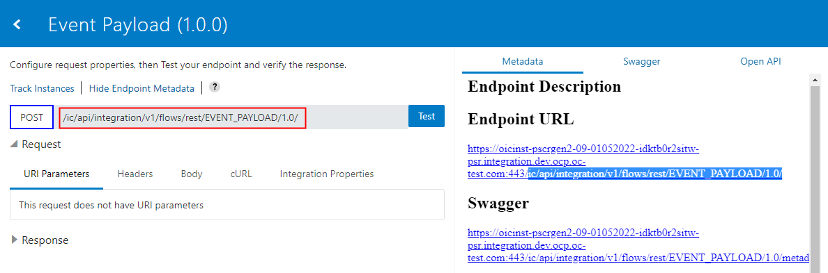

Copy the endpoint URL from your integration.
In the test mode, you can grab the portion of the URL beginning with /ic/.… for OIC Generation 2 and integration/v1/flows/rest/... for OIC Generation 3. For example:

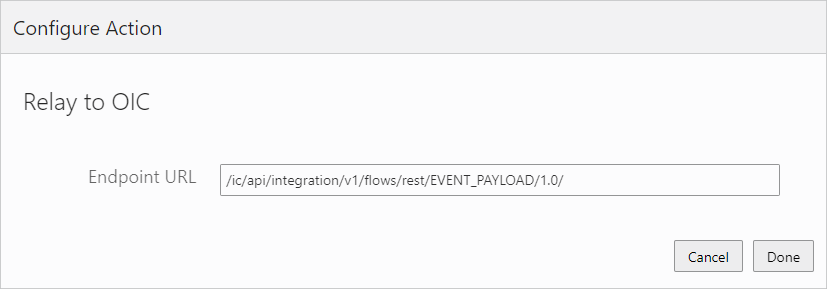

Create your rule in Business Rules Framework, and select Relay to OIC as the action type.
Click the Configure link.
On the Configure Action dialog box, add the endpoint URL form your OIC integration.
Note: If you have migrated from OIC Generation 2 to OIC Generation 3, you must update the format of the endpoint URL to reflect OIC Generation 3. -
Click Done.
