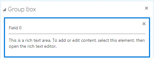

  1. Insert a group box into your form where you want to place the rich text area.
  2. From the Add New > General list, drag and drop a rich text element into the group box.
  3. Select the rich text area element.
    This example illustrates the rich text area element being selected prior to rich text being added.
    Rich text area element selected.
  4. In the Field Attributes panel, click Edit to open the Rich Text Editor dialog box.
