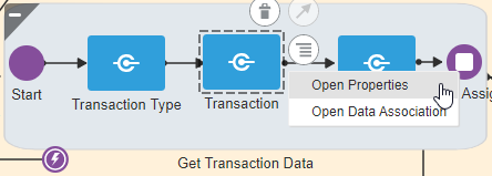

  1. Select Processes in the left-hand navigation to display the process.
  2. Expand the Get Transaction Data node in the process definition, select the transaction data node, and select Open Properties.
    This example illustrates a collapsed process definition node. Details are in the surrounding text.
    Process Definition: Get Transaction Data node
    This example illustrates an expanded process definition node. Details are in the surrounding text.
    Process Definition: Expanded Get Transaction Data node
    This node can have other names, such as Get Application, Get Permit Data, and so on. It is typically the first system task in the process definition, where the process definition gets the required initial data, including transaction type, transaction data, and so on.
