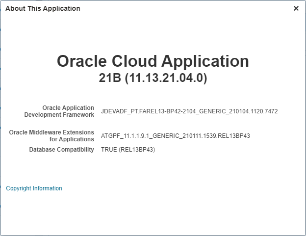

To identify environment release level:
Navigate to the Fusion Setup Manager: .
Click the profile icon to display the Settings and Actions drop-down list.
Click About This Application.
This example illustrates how to determine the release level of an environment.
