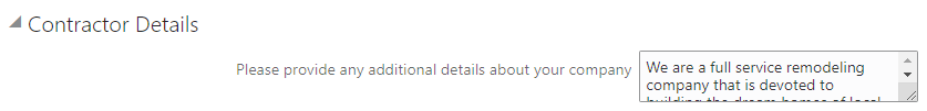

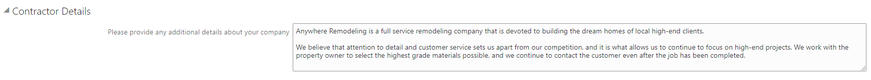

Increasing the Display Area for Field Content

This example illustrates a Text area field type displaying the default amount of visible space.
      Use the Full Width and Rows field attributes to expand the display size of certain field types.
This example illustrates the Full Width and Rows display options. Details are in the surrounding text.

This example illustrates a rich text field type with the Full Width option enabled and the Rows value set to 5 to display more field content for users.
