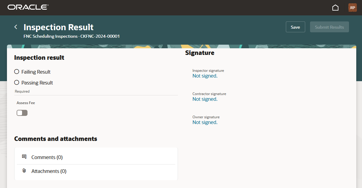

Submitting Inspection Results
In the Inspector Application on a mobile device, you can submit inspection results to complete assigned inspections one at a time through the inspection or submit results for several inspections at once by selecting inspections on the Inspection Tasks page.
Whether you complete an individual permit or license inspection by accessing the Inspection Result page from the inspection overview detail panel or you provide results in a batch that you select on the Inspection Tasks page, the information needed to complete the inspections is the same. Here's how to provide and submit the permit and license inspection results:
Review calculated inspection results or provide an overall inspection result for an individual inspection or several selected inspections.
Indicate whether a fee should be assessed for the inspection or inspections.
Capture the inspector, contractor, and property owner signatures.
Add inspection comments and support documents as attachments.
Submit the inspection or inspections.
Inspectors can’t submit a completed inspection if required comments or signatures are missing. You must also complete all checklists and required checklist items as well as resolve any application conditions that affect the inspection. For example, you can't result an inspection for a permit or business license if a condition with the rule Prevent Inspection Result or Prevent Final Inspection has been applied.
Your agency determines whether comments are required in the agency-level permit and business license options during the implementation of Oracle Permitting and Licensing. Comments can be optional, required for all results and cancellations, or required for failed results and cancellations.
Your agency decides which signatures are required for each inspection type.
Your agency can also configure the system to send out notifications when an inspection is complete or the final inspection has passed. For more information, see "Sending Notifications" in this topic.
This example illustrates the Inspection Result page for resulting an individual inspection, containing the fields described in the surrounding text.
Let's take a look at the information used to result inspections:
Page Element |
Description |
Inspection result section |
Click the radio button for the desired inspection result. The options available depend on agency setup. Depending on the method used to calculate the results, the system may automatically calculate the final result based on checklist results or you can select a passing or failing result. Click Clear to deselect any selected options. |
Assess Fee |
Turn on the Assess Fee switch to indicate that a fee should be assessed. If fee assessment is configured by your agency and this switch is turned on, the system calculates the fee and charges it back to the applicant when you submit the inspection. For more information, see the "Assessing Fees" section in this topic. |
Comments and attachments section |
Click the respective buttons to add comments or attachments. |
Signature section |
Click the Not signed link to add an inspector, contractor, or owner signature. Signatures might be marked as required. Click Save to submit the signature. You must also add the names of contractors and property owners when adding their signatures. To see submitted signatures, click the name link in the signature section or Signature panel in the inspection details; the date and time appear for each submitted signature. If all of the signatures are set up by the agency as not required, this section isn't available. |
You can save your work when you make updates and submit the results using these buttons:
Page Element |
Description |
Save |
Click the save button on the Inspection Result page to save any updates before submitting the results. |
Submit Results |
Click to submit the entered inspection results, comments, attachments, and signatures. Note:
Inspectors can’t submit a completed inspection if required comments or signatures are missing. You must also complete all checklists and resolve any application conditions that affect the inspection. |

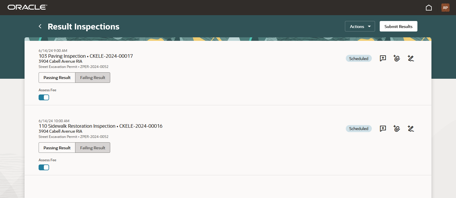

Completing Multiple Inspection Tasks
Inspectors and inspector supervisors can provide results for several inspections at once selected from a central location in the Oracle Inspector web application on a mobile device without first navigating to the inspection overview panel then to the Inspection Result page for each inspection.
This example illustrates the Result Inspections page for resulting multiple inspections, containing the fields described in the surrounding text.
Here's how to provide results for inspections in a batch:
On the Inspection Tasks page, click the Result Multiple button.
Select the checkboxes for the inspections that you want to provide results for. The number of selected inspections is displayed.
You can only provide results for inspections that are assigned to you or you have the appropriate permissions. The inspections must also meet the requirements listed here:
The inspection status isn't completed or canceled.
The inspection checklists already have results, if they have checklists.
When an agency enables an inspection type to use checklist items, inspectors can't result the inspection until the required checklist items are complete.
The applications don’t have conditions like Prevent Inspection Result or Prevent Final Inspection applied to them.
Prerequisite inspections, if any, are already complete with passing or corrected results.
For final inspections, all other required inspections are complete with passing or corrected results.
If an inspection doesn't meet these requirements, you can't select it.
Click Result Inspections.
View the inspections you've selected on the Result Inspections page. Here you have a choice:
You can complete the result for each inspection on the Result Inspections page directly without going into each individual inspection. In this case, you can provide a different result for each inspection. You can also provide comments, attachments, and signatures, and turn on the assess fee option.
You can apply the same result and assess fee option to all of the selected inspections at once by clicking .
Select the results that you want to apply to all of the inspections on the Result all inspections drawer.
Note:The Oracle Inspector web application featuring the Redwood Experience doesn't currently support applying the inspector signature to all of the inspections in the batch.
Provide the information on the inspection result pages as described here:
Page Element
Description
Result
On the Result all inspections drawer, you can select a passing or failing result that is applied to all of the inspections on the Result Inspections page. This option overwrites any existing results that have been calculated, but won't override the system-calculated result for inspections using the scoring method.
Assess Fee
Turn on the Assess Fee switch to indicate that a fee should be assessed. If fee assessment is configured by your agency, the system calculates the fee and charges it back to the applicant when you submit the inspection. For more information, see the "Assessing Fees" section in this topic.
The switch on the Result all inspections drawer applies fee assessment to all of the inspections on the Result Inspections page.
or
Click the Add Signatures pen icon with the plus sign on the Result Inspections page to enter Inspector, Contractor, or Property Owner signatures. Click the Not signed link to open the Signature drawer and sign. You must also add the names of contractors and property owners when they add their signatures.
Click the Show Signatures signature icon to open the Signature drawer and view the added signatures or add more.
or
Click the Add Comments conversation bubble icon with the plus sign to enter comments. Note that you can't add comments on the Result all inspections drawer.
Click the Show Comments icon to open the comments page and view the added comments or add more.
or
Click the Add Attachments paperclip icon with the plus sign to add attachments. Note that you can't add attachments on the Result all inspections drawer.
Click the Show Attachments icon with the paper and paperclip on it to show the added attachments or add more.
On the Result all inspections drawer, you can select a result and turn on the Assess Fee switch. Click Apply to All to apply your selections to the inspections in the batch. Note that you can't add signatures, attachments, or comments on the drawer.
On the Result Inspections page, click Submit Results. You must submit the results and selections to complete the inspection.
Note:The option to submit results for all of the inspections isn't available if any required comments or signatures are missing.
