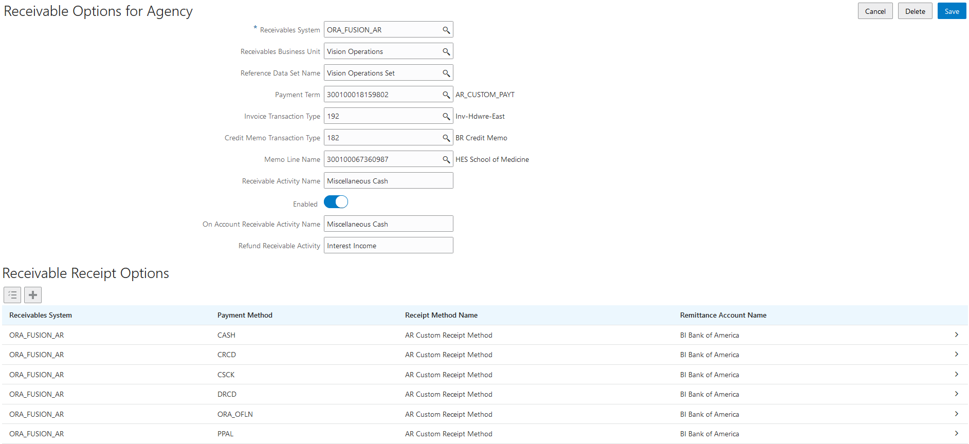

This example shows the Receivable Options for Agency page.
Enter values for the following fields:
Page Element
Description
Receivables System
Select your Oracle Receivables system.
Receivables Business Unit
Enter the Oracle Receivables business unit associated with your agency.
Reference Data Set Name
Select the set of shared configuration data used across your business units. This value determines the values available for the other setup fields on this page.
Payment Term, Invoice Transaction Type, Credit Memo Transaction Type, Memo Line Identifier
Enter your invoicing information. The reference data set you selected determines the values available to select in these fields.
Note:These fields are required even though invoicing integration is not currently available.Receivable Activity Name
Enter the default receivable activity name that Oracle Permitting and Licensing assigns to payments that don’t match receivable options defined at the record type or fee item level. Make sure that this value matches the value defined in Oracle Receivables exactly.
Enabled
Turn on this switch to enable the integration between Oracle Permitting and Licensing and Oracles Receivables. When this switch is off, Oracle Permitting and Licensing processes all received payments using normal accounting.
On Account Receivable Activity Name
Enter the receivable activity name that Oracle Permitting and Licensing assigns to overpayments. All overpayments for the agency are assigned the same receivable activity name and do not have receivable options set at the record type or fee item level.
Refund Receivable Activity
Enter the receivable activity name that Oracle Permitting and Licensing assigns to refunds. All refunds for the agency are assigned the same receivable activity name and do not have receivable options set at the record type or fee item level.
Note:Oracle Permitting and Licensing generates negative miscellaneous receipts for refunds.
