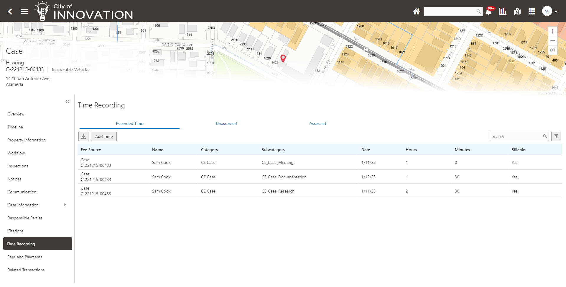

You add time entries directly on the respective pages for the transaction you are working on.
This is an example of a Time Recording page in the case details

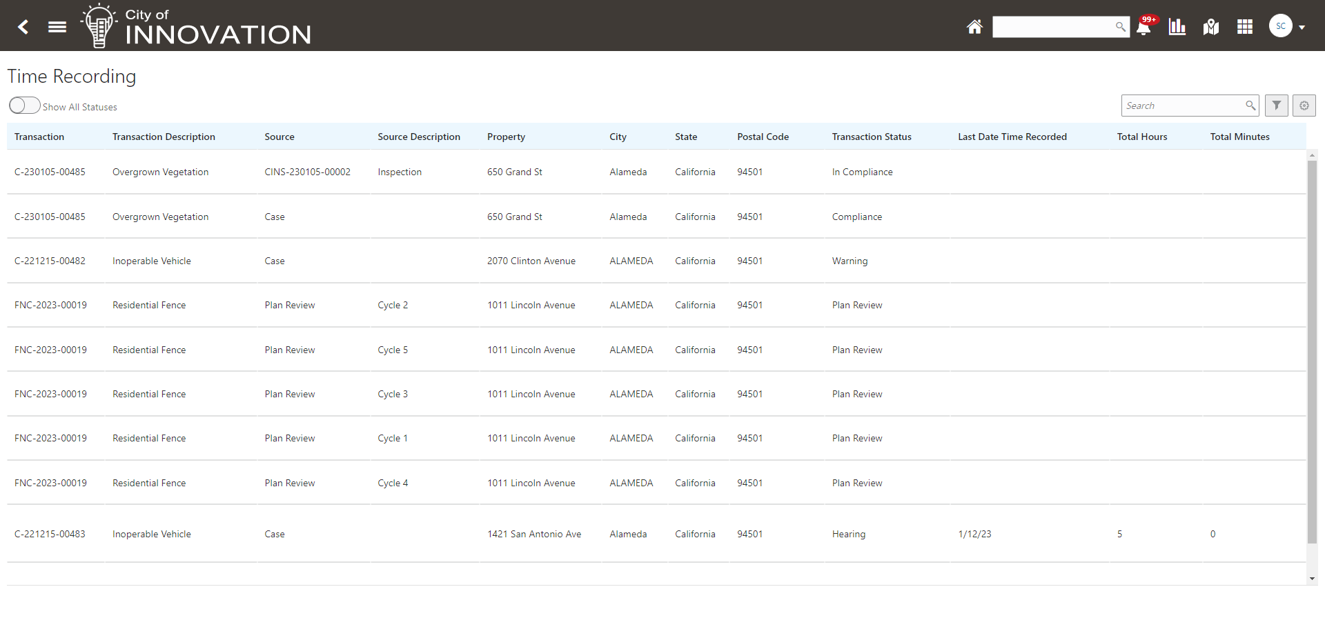

Additionally, you can quickly access transactions using the Time Recording tile on the Agency Springboard. This page displays transactions that you are assigned to or for which you have already recorded time.
This is an example of a Time Recording page accessed from the agency springboard
By default, this page displays permit and planning transactions that aren't in a terminal status (Completed, Denied, Certificate of Occupancy, Void, or Withdrawn). For example, it won’t display expired permit inspections or completed plan review cycles. Turn on the Show All Statuses switch to show all transactions assigned to you regardless of status.
Click a row to access the transaction page where you can enter your time. You must have appropriate permissions to add time entries.
Adding a Time Entry
Access the transaction that you want to add time for.
Click Add Time.

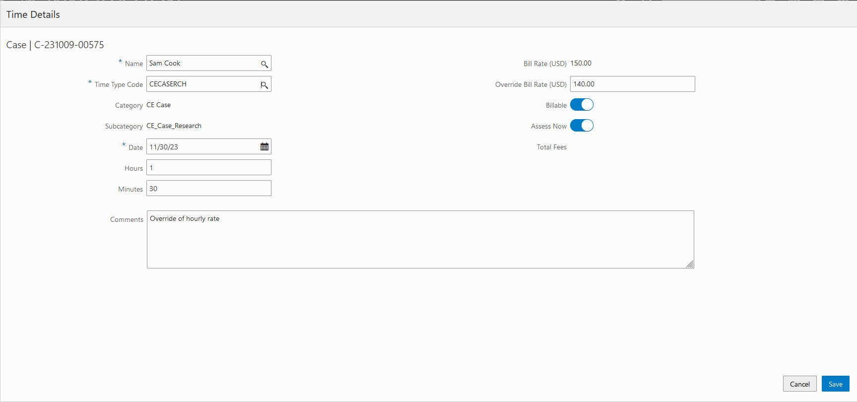

This example illustrates the Time Details page for a case
On the Time Details page, enter values for the following fields:
Page Element
Description
Name
Enter the agency user name of the person performing the task. Staff who have the ability to enter time for others, such as billing supervisors, can select any agency staff member in this field. All other agency staff automatically have their name populated in this field and can’t change it.
Time Type Code
Enter the time entry type code that you want to use. The page displays the category and subcategory associated with the code that you select in the Category and Subcategory fields, respectively. The time entry type code also determines the default values of the Billable and Assess Now switches on this page and whether those default values can be changed.
For more information on time entry types, see Setting Up Time Entry Types.
Date
Select the date that you’re entering time for. The current date is the default value.
Hours and Minutes
Enter the amount of time you spent on the transaction in hours and minutes. You can select 0 to 23 in the Hours field and 0 to 59 in the Minutes field.
Bill Rate
Displays the bill rate in USD associated with job title in the user profile of the agency staff. For more information, see Defining Job Titles.
Override Bill Rate
Enter an amount in USD that overrides the default bill rate in fee calculations. Only agency staff with time recording management roles have permission to override the job title bill rate in the time details.
Billable
Use this switch to indicate whether the time is billable. Whether this switch is turned on by default or can be overridden is determined by the time entry type that you select.
Assess Now
Use this switch to indicate whether the fees associated with this time entry are assessed immediately when you save it.
Note:This switch appears only for staff who have the ability to enter time for others. It is disabled when the Billable switch is turned off.
Total Fees
Displays the fees associated with the time entry, whenever applicable.
Comments
Enter any additional information you want to record for the time entry.
Click Save.
