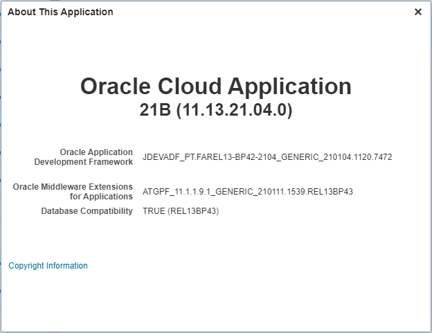

Identify Source and Target Release Levels
You export the solution package from the source environment, and you import it on the target environment. Both the source and the target environments must be on exactly the same release and patch level for the exported form to function as expected on the target environment. Before you begin the process of exporting a form to a target environment, ensure that the release level of both environments match.
To identify environment release level:
Navigate to the Fusion Setup Manager: .
Click the profile icon to display the Settings and Actions drop-down list.
Click About This Application.
This example illustrates how to determine the release level of an environment.

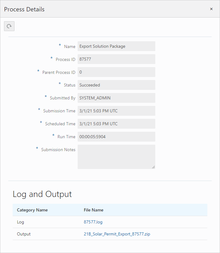

Click the Process Monitor link and locate the row in the grid for your process ID, and monitor its progress.
When the process completes, click the View More Details link for the export process.
On the Process Details page, use the Log and Output grid to view the log for your process and to access the solution package ZIP file from the Output row.
Download the solution package ZIP file to a local folder.
Process Details page showing the generated solution package in the Output row.
