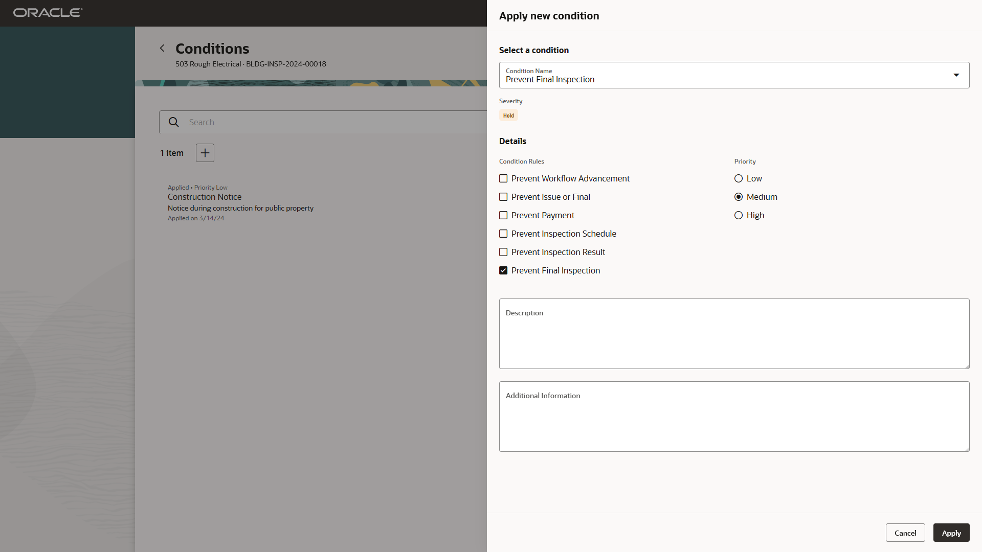

This example illustrates the drawer to apply a new condition from the Conditions page in the Inspector Application
Click the Add (+) button on the Conditions page or inspection details panel to apply a new condition. When you apply a condition on the Apply new condition drawer, you select a condition and condition rules, and add a description. Here's how to apply a condition:
Page Element |
Description |
Select a condition |
Select a condition name from the drop-down options. The available conditions depend on agency setup. For more information, see Applying Conditions to Applications and Setting Up Conditions. |
Severity |
Displays a badge with the level of severity for the selected condition, such as Lock, Hold, or Notice. |
Condition Rules |
Select the rules for the condition, or accept the default rules set up by the agency. For example, Prevent Final Inspection. |
Priority |
Select the priority level, such as Low, Medium, or High. The priority level doesn't affect the severity or rules and is for information only. |
Description |
Enter a description of the condition. |
Additional Information |
Enter additional information, if desired. |
Click the Apply button to apply the condition to the inspection.
