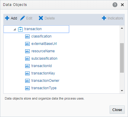

Creating a Data Object to Store Start Event Arguments
In the next task you will define the start arguments for the Start event. In this procedure, you create the structure to store the arguments.
This procedure involves:
Creating a business type using the business object option.
Creating a data object and associating it with the business object.
To create the data object for start event arguments:
Open the process definition.
Select Business Types from the left panel.
Note:Notice the other business types created automatically when importing the downloaded JSON, such as ResponseTransactionData.
Click Edit in the header, which causes the Create button to appear.
Click Create, and select New Business Object.
On the Create Business Object dialog box, enter the business object name, such as InitTransaction, and select the Parent Module as BusinessData.
Click Next.
Use the Add Attribute button to add these string data types to the business object.
Attribute Name
Data Type
transactionKey
String
transactionType
String
externalBaseURL
String
resourceName
String
transactionOwner
String
transactionId
String
classification
String
subclassification
String
Click Finish.
Return to your process definition diagram.
Click the Data Objects button.
Click Add.
On the Create Process Data Object dialog box, make these changes:
Field
Value
Name
transaction
Data Type
Business
drop-down list
BusinessData.InitTransaction
Click Create.
This example illustrates the expanded transaction business data object, with the required string data within it.
