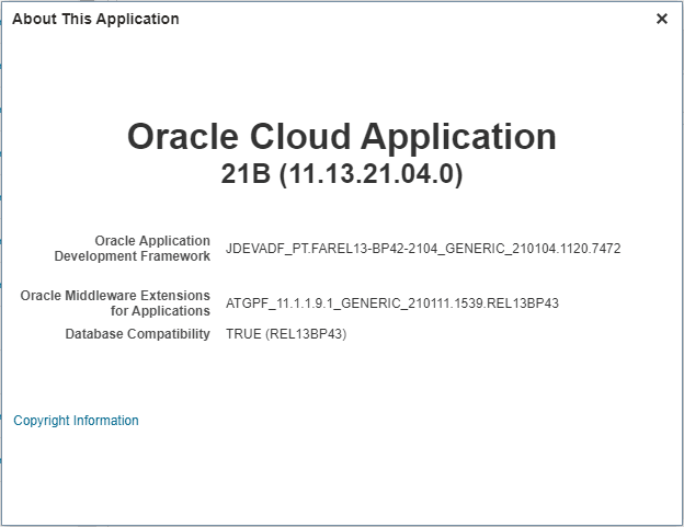

To identify environment release level:
  1. Navigate to the Fusion Setup Manager: Navigator > Setup and Maintenance.
  2. Click the profile icon to display the Settings and Actions drop-down list.
  3. Click About This Application.
    This example illustrates how to determine the release level of an environment.
    About This Application page
