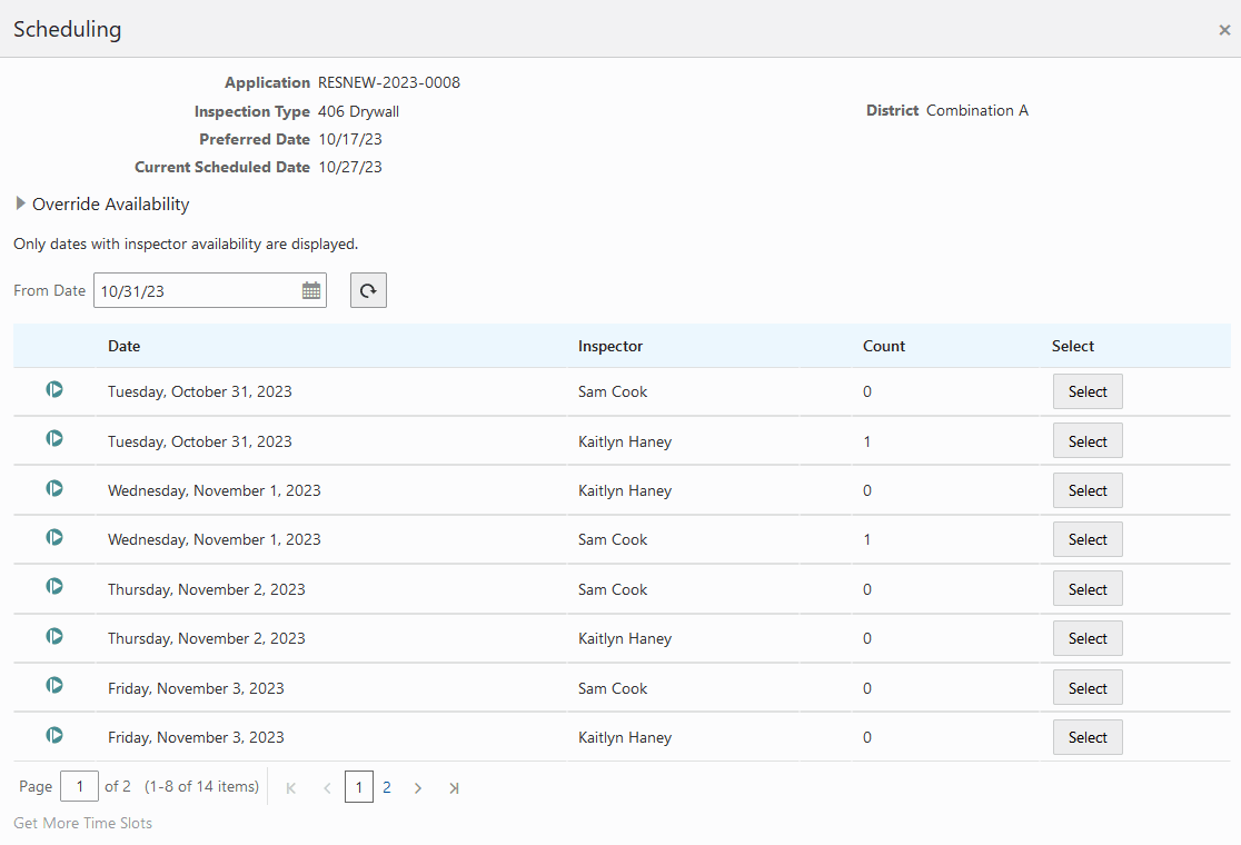

The Scheduling modal page lists the dates that are available for you to schedule the inspection, starting with the date in the From Date field. The default value of this field depends on the scheduling method of the inspection:

This example in the classic interface illustrates the Scheduling modal page for an inspections supervisor. Inspections supervisors can see the inspector names and override availability.
This example in the classic interface illustrates the Scheduling modal page for an inspection that has been configured to use the count assignment method. An icon (not shown here) will be displayed next to the Count value for an inspector who has reached the limit. Only inspector supervisors can see the inspector name and count columns.
Select an available Time from the drop-down list and click Select next to the inspector and date on which you want to schedule the inspection. Depending on the time entry method set up for the scheduling method, you may only be able to select a date or a date and time range.
Note:A flag icon appears next to preferred inspectors.
If an inspector is not available for the date and time that you want, inspections supervisors can expand the Override Availability section of the modal page to manually assign an inspector for a specific date and time. Select the Inspector, Date, and Time and click Select to assign the inspection. This is useful when supervisors need to load balance inspectors and ensure that each inspection is assigned to an inspector.
