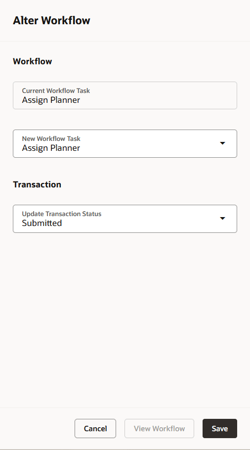

Altering Workflow
If needed, supervisors or administrators can change the workflow for a transaction type manually. This enables you to change the workflow step in case of system outage, user error, and so on.
To alter workflow:
  1. Click the Options button and select Alter Workflow to display the Alter Workflow drawer page.
  2. In the Workflow section, Select the desired workflow step from the New Workflow Task drop-down list.
  3. In the Transaction section, select the proper status for the workflow step from the Update Transaction Status drop-down list.
  4. Click Save.
If the alter request is not successful, supervisors have the option to redo the alter request and try again.
You can't alter a workflow task back to a pending status.
Click View Workflow, if you need to review the steps and swimlanes in the underlying workflow process diagram as defined in Oracle Process Automation. This displays an image of the entire workflow process diagram you can view. Note that View Workflow isn't supported in the Redwood interface.
