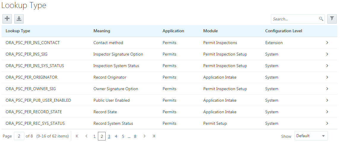

This example illustrates the Lookup Type page. Details are in the surrounding text.
To modify a lookup type:
Select
On the Lookup Types page use the Search box to filter the lookup types by keyword.
For example, to view the Business Type lookup type, enter business in the Search box.
Click on the row for the lookup type you want to view.
View the contents of the Lookup Type Details page.

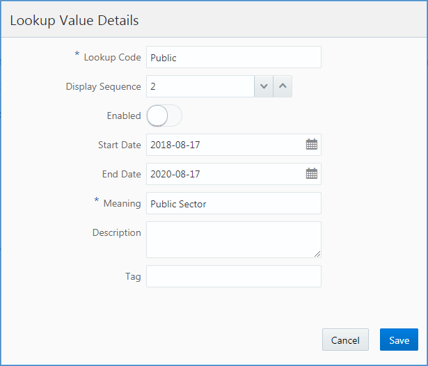

This example illustrated the Lookup Value Details page. Details are in the surrounding text.
You can add lookup values to lookup types with a configuration level set to User or Extension.
To add lookup values:
Select
On the Lookup Type Details page, click Add under Lookup Value Type.
On the Lookup Value Details page, enter these values:
Page Element
Description
Lookup Code
An internal application code for each lookup value that is not visible to users. It is typically a shorter, less user-friendly representation of the item. For example, ORA_DRIVER_LIC for State Driver’s License, or LEN for Length, if listing units of measurement.
Note:Lookup lists created in the designer for user-defined fields on an intake form begin with PSC.
Display Sequence
Control in what sequence the lookup value appears in the list displayed to users, where 2 appears above 3. If you do not specify a sequence, the application displays the items in the order they were entered.
Enabled
Turn on to make a lookup value active. If a lookup value is not enabled, then the application does not display it to the end user in the list of values for that lookup type.
Note:It is not recommended to disable lookup values once your implementation is in production because this can invalidate existing transaction data.
Start Date
Set a start date for the lookup value to become active. Even if the lookup value is enabled, if a start date is set, the application does not display the lookup value until the start date is reached.
End Date
Set an end date for a lookup value to no longer be displayed in a list of values.
Meaning
The display name for the lookup value. End users see this value in the list of values displayed at run time. They do not see the Lookup Code value.
Description
Provide any additional information to help identify the purpose of the lookup value or clarification regarding what it represents.
Tag
Tags allow you to add a label to your lookup codes. A tag can be used to categorize lookups based on facilitating searches or guiding how a lookup should be used.
Click Save.
