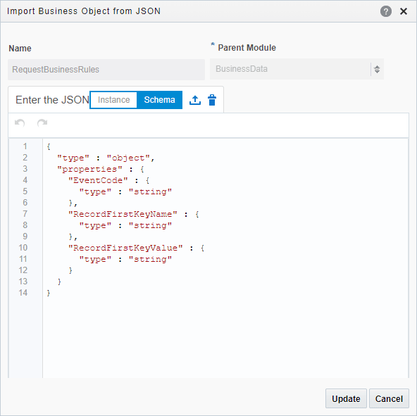

Click Request
Click the + icon next to the Body field to open the Import Business Object from JSON window.
Enter RequestTransStatusUpdate in the Name field.
Click Schema.
Click the Import from File icon next to the Schema button.
Locate and upload the RequestTransStatusUpdate.json file that you downloaded from My Oracle Support.
The imported JSON code appears in the Import Business Object from JSON window.
Click the Import button at the bottom of the window to save the code and close the window.

Configure the JSON Request.
In the Response and Request section, select the Request tab, and click Create business object under the Body field to open the Import Business Object from JSON dialog box.
For Name enter a recognizable name for the request, such as RequestBusinessRules.
In the Enter the JSON edit box, select Schema.
Copy and paste the following JSON.
{ "type" : "object", "properties" : { "EventCode" : { "type" : "string" }, "RecordFirstKeyName" : { "type" : "string" }, "RecordFirstKeyValue" : { "type" : "string" } } }
This example illustrates the request JSON.
Click Import.
