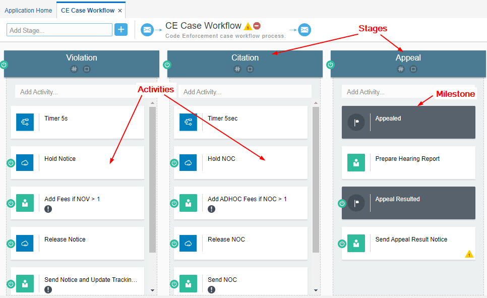

This example illustrates the main elements of a Code Enforcement dynamic workflow process. Details are in the surrounding text.

Stages
Stages enable you to organize activities into phases of a process. Stages can run at the same time or one after another. Examples of stages in the Code Enforcement process definition include Violation, Citation, Appeal, and so on. Each stage represents a different phase of the workflow with its own set of activities.

Activities
Activities represent actions or tasks that need to be completed within the process. Activities can be carried out by a human, or they can be automatically completed by calling another process or integration, such as a REST service.
Milestones
Milestones represent a sub-goal within a process. Milestones are typically defined to track progress of a process.
