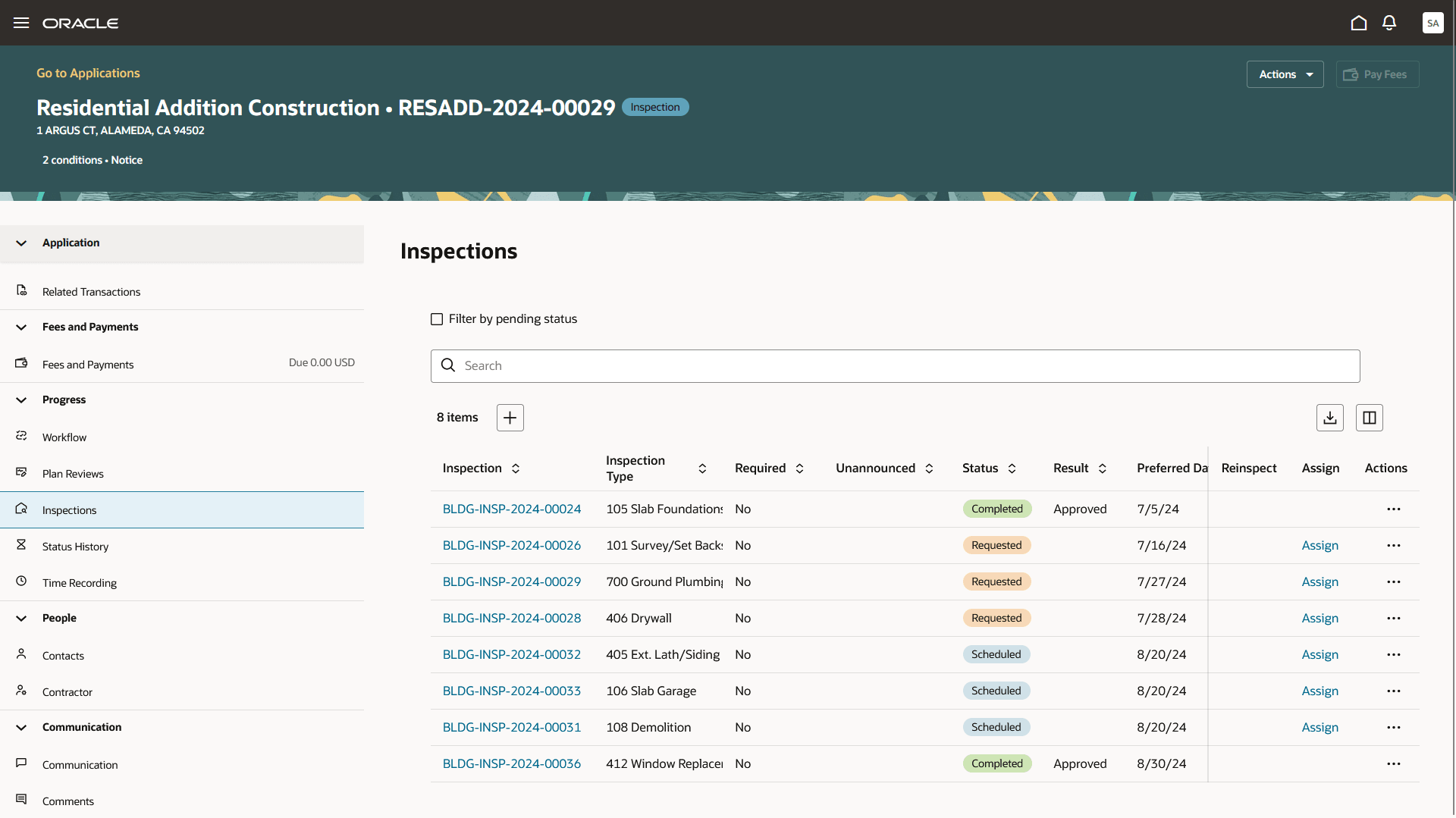

Example of the Inspections list page in the permit application details
Inspections page in the permit detail pages

Viewing Inspection Activity
Here's how to view the inspections associated with a permit.
  1. After you access the permit, expand the Progress section in the left navigation panel.
  2. Click Inspections in the left navigation panel to open the inspections list for the permit.
  3. On the permit's Inspections list page, use the search or filter for finding or viewing the inspections in the grid. You can use delivered filters or enter text in the search field. Remove the search text if no matching inspections were found.
    You can also click the Export button to download the list of inspections.
  4. Here's how you can monitor inspection activity in the grid:
