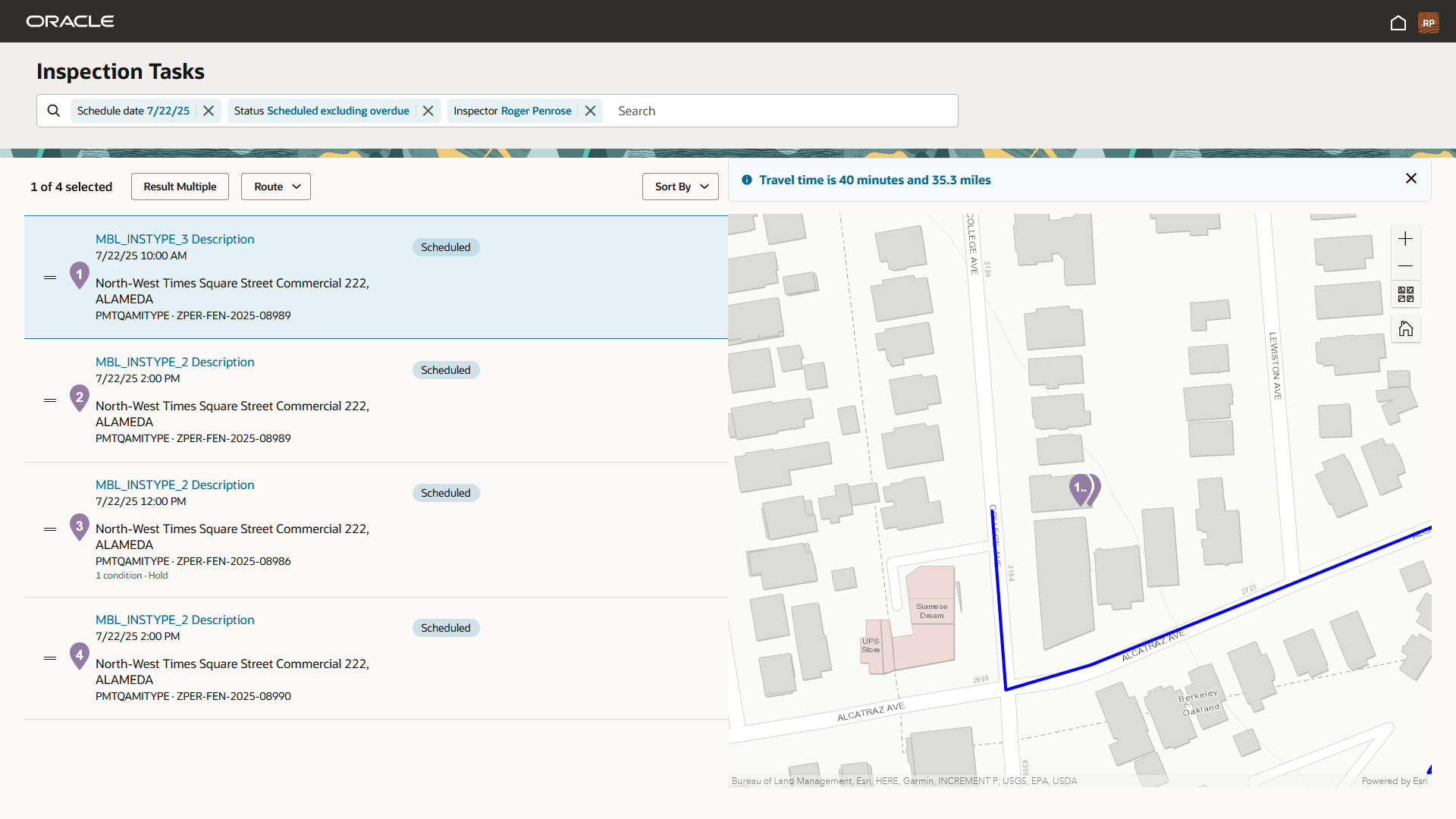

This example illustrates the routing on a map when the inspector selects the option to show the route. The route calculations are based on the inspector's current location and, in this example, are shown in miles as set up by the agency.
Inspection Tasks Page- Map with Inspection Route on Map
The inspector can use the handle for an inspection to drag and drop it in a different order in the list. When you select the option to show the route, the inspection route is displayed on the map.

Handle used to move inspections into a different order
Use the drag-and-drop handle for the inspection entry to reorder the list of inspections. The inspection order is maintained in the list on the inspector's device.
Route
Select from these options:
  • Show - Displays the inspection route on the map in the order specified in the current day's inspections list. Depending on your agency's setup, the distance is shown in miles or kilometers.
  • Hide - Turns off the inspection routing on the map.
  • Optimize - Determines a shorter route based on the ESRI key. The time and distance savings are displayed in a message.
Inspection pin that corresponds to a location on the map
Click the inspection pin on the task list to send the location of the inspection and inspector's device to a navigation application, such as Google Maps or Apple Maps. The navigation application then displays driving directions to the location of the inspection.
