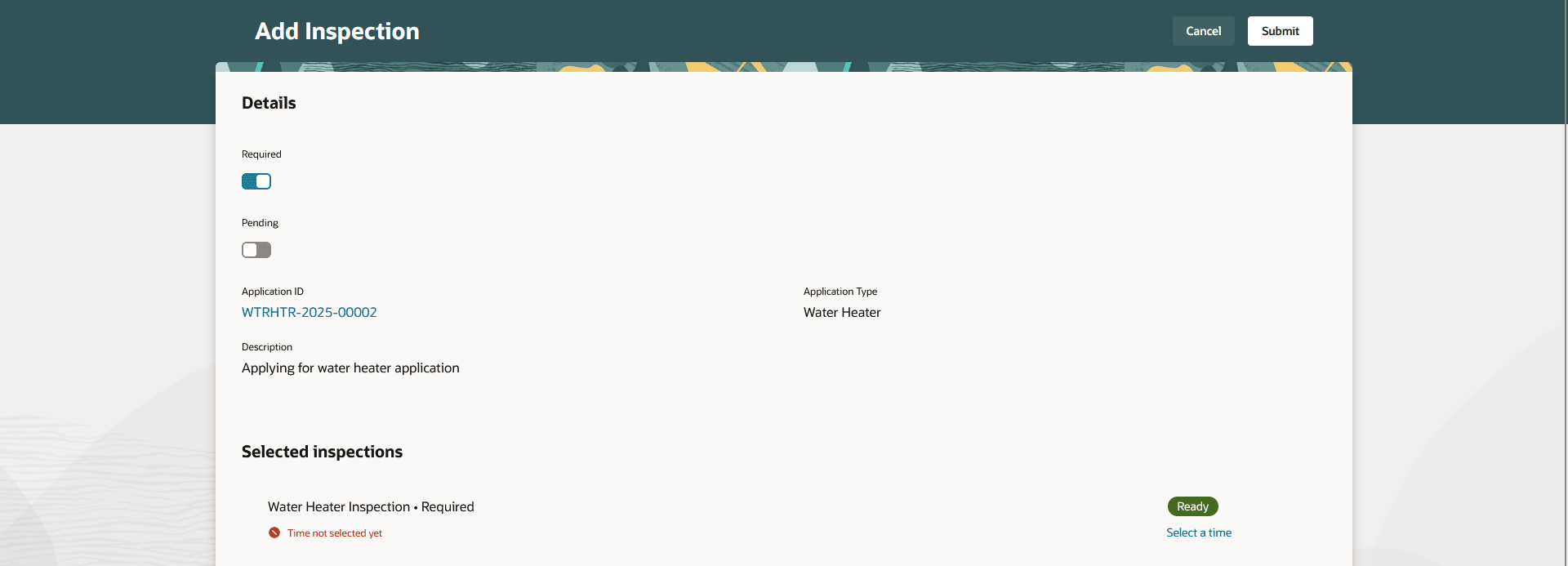

The Add Inspection request page for a single inspection can look like this when a time hasn't been selected yet:
Add Inspection page - partial page view showing Details and Selected inspections sections (1 of 2) Add Inspection page - partial page view showing Request section (2 of 2)
The scheduling link will display either Select a Time or Select a Date based on setup in the agency-level permit options, in the Scheduled Time Range section. In this example, you must click the Select a Time link to schedule the inspection because the inspection was setup with a Time Entry Method of Specific Time for the Schedule scheduling method. For more information, see Setting Up Agency-Level Options for Permits.
If you selected more than one inspection type, they are all displayed in a Selected Inspections list. The inspection's scheduling link will display Select a Time for any scheduling method as long as the Time Entry Method in the agency options isn't set to Date only. If any of the scheduling methods have the Time Entry Method set to Date only, then the link will display Select a Date, because only a date value is used (preferred date, ready-by date, or assignment date, when the setup uses the count assignment method for inspectors). For more information about the different scheduling methods that inspections can have, see Assigning Inspections and agency-level setup documentation.

  1. Click the + (Add) button.
  2. On the Add inspection drawer, the information for the application you are working on is reflected in the fields.
    When the permit application status is Withdrawn or Completed, you can't add new inspections anymore. However, you can add inspections for business licenses in a Completed status.
  3. Turn on the Pending switch to set the status of the selected inspection to Pending.
    This option is available only if set up by the agency and isn't available for registered public users. For more information, see the "Working with Pending Inspections" section in this topic.
  4. In the Select inspections section, click the Inspection Group button to see a list of the inspection types that are available based on the inspection group associated with the permit application type.
    Agency staff can select the All button to view all inspection types available for selection. The Inspection Group and All buttons aren't available to public users; they only see a list of inspection types associated with the inspection group.
    For each inspection type listed in the Select inspections section, you'll see this information:
    Page Element
    Description
    Inspection type description
    Displays the description set up for the inspection type code.
    Prerequisites
    Displays prerequisite inspection types, if any.
    Final inspection
    Indicates that this is the last inspection that needs to be done to complete the application.
    Required badge
    Indicates that this inspection type is required to complete the application.
    Unannounced
    Indicates whether the inspection type is for an inspection where the inspector arrives unannounced, without any prior communication sent to the applicant. Unannounced inspections are hidden from applicants and contacts with application access until the inspector has submitted the inspection results.
  5. Select the checkbox next to each inspection type that you want to add.
  6. Click Continue to access the Add Inspection request page.
  7. Select values for these fields:
    Page Element
    Description
    Required
    Turn on the switch to make an inspection required.
    The Required option defaults to the inspection type setting on the Inspection Group Details page. If the inspection is outside of the inspection group or is an unannounced inspection, the setting defaults to not required.
    Public users can't change the Required setting for an inspection.
    Pending
    Turn on the switch to make this inspection a pending inspection on the inspection request page.
    Public users can't change the Pending setting for an inspection. For more information, see the "Working with Pending Inspections" section in this topic.
  8. Depending on agency-level setup, click the Select a Time or Select a Date link to request or schedule the inspection.
    Depending on the scheduling method set up for the inspection type, agency staff and applicants can enter times in the preferred date and time fields or ready-by date and time fields, or select a time. Depending on agency setup, only date fields or date and a time range may be available. See the section, "Selecting an Inspection Time" for more information.
  9. Click the Remove action menu item to remove inspection types that you don't want to include in your inspection request. At least 1 inspection type is required in the request.

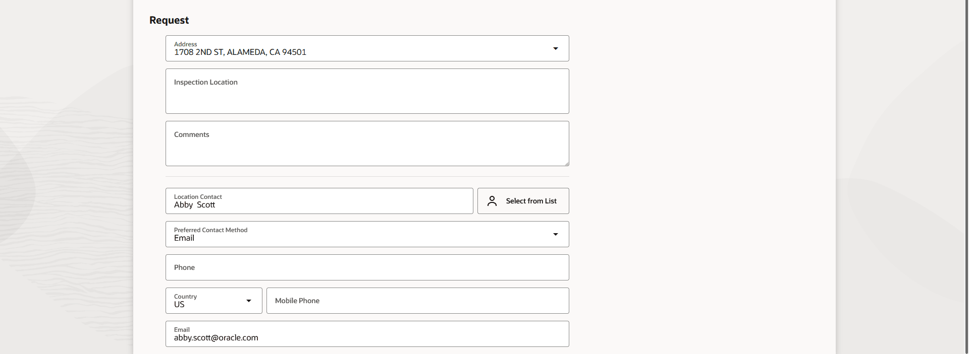

  10. In the Request section:
    • Enter or update the address, inspection location, comments, location contact, and location contact's contact information.
    • (Optional) Select a Reference Entity from the drop-down list.
      This option is only available depending on agency setup for reference entities and permits. Depending on setup, you may be able to further refine the inspection to indicate reference entity attributes. For more information, see the "Adding Reference Entities to Inspections" section in this topic.
  11. Click the Submit button.
For information about updating and viewing dependencies, which is only available in the classic inspection request interface, see Working with Inspection Dependencies. For information about working with subapplications, which is only available in the classic interface, see Working with Linked Permits.
If the Inspection Requested communication event is configured, the system automatically creates an email notification that an inspection request has been created. For more information, see Delivered Communication Events.
