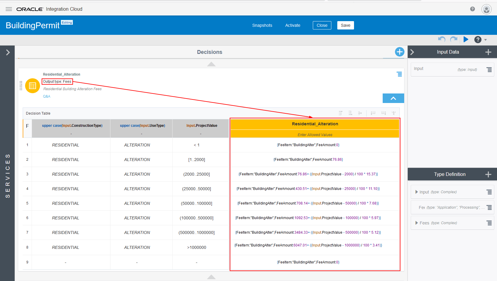

(Required) Add the output data type name to every decision and use allowed values in the Decision Table grid.
To edit a decision, click the decision menu button and select Edit.
Select the defined output type from the Output Type list.
This example illustrates the output data type name Fees added to the Residential_Alteration decision. The output type provides constraints on which values are allowed in the decision model.
This is an example of the final decision values based on the output type.
The decision output type in the Residential_Alteration decision is Fees. The validation ran on the Fees values entered in the Decision Table, and no errors were returned.

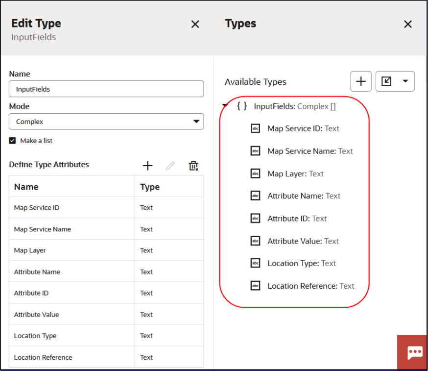

Configuring GIS-Based Fees
You can define fee calculation criteria using spatial data coming from the Map Layer Content field group in your intake forms. For example, agency staff can define in a decision model that a district improvement fee is required if the project location falls within a specific district.
To incorporate GIS attributes into your fee decision models, you need to:
Include these field groups in your intake form:
Property or Business Location
Map Layer Content
Create a DMN model that includes GIS-related inputs configured as a "list," which can accept multiple input values.
Map the attributes to intake form fields as usual within the Intake Form Designer.
