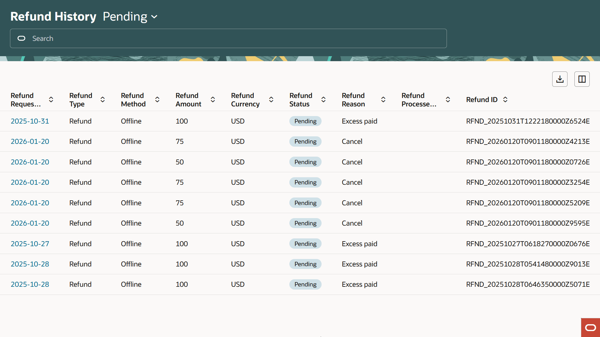

Reviewing Refund History
  1. In the search bar, enter Refund History.
    The Refund History page displays all of the refunds requested or processed by the agency. You can search for and sort refunds by:
    • Refund ID
    • Refund Type
    • Refund Method
    • Refund Request Date
    • Refund Amount
    • Refund Currency
    • Refund Status
    • Refund Reason
    • Refund Processed Date
  2. Select a refund to view additional details on the Refund Detail page.

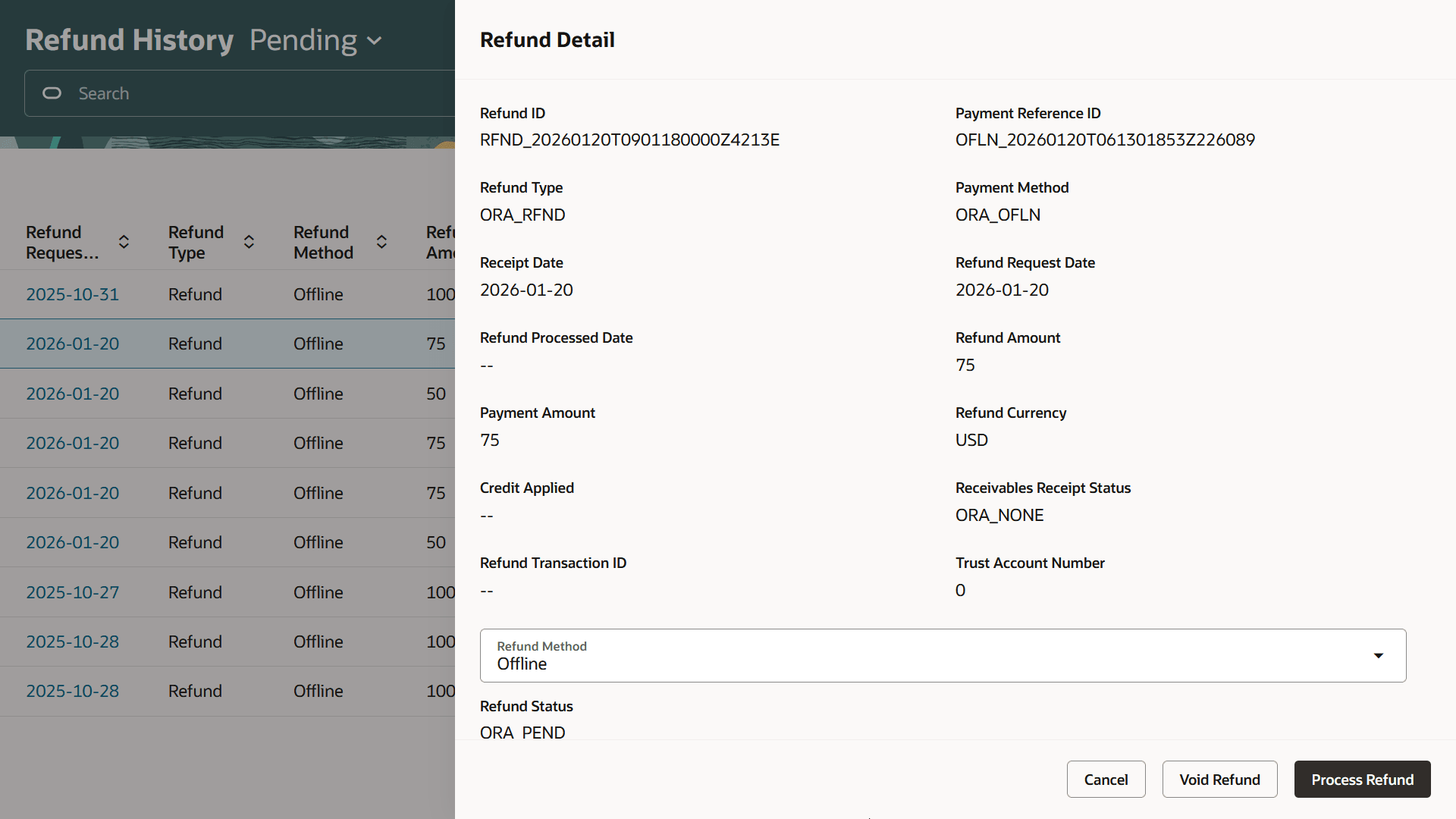

    This example shows the Refund Detail page.
    Example of the Refund Detail page
The Refund Lines grid displays the items included as part of the refund. You can select a refund to view additional details on the Refund Detail drawer.
Processing Refunds
  2. Use the drop-down to select a refund with a Refund Status of Pending.
  3. Select Offline if you are issuing a manual check for the refund, or issuing an electronic refund through a system that is not connected to Oracle Permitting and Licensing. This is the only option available for payments that were made by check or cash.
    Select Credit Card to credit the refund back to the credit card that was used to make the payment.
    Refunds to credit cards are processed through Oracle Fusion Payments. For detailed information on setting up the integration with Oracle Fusion Payments, see Oracle Permitting and Licensing: Financial Integrations.
    Agency Staff processing refunds must have the Process Refunds Job Role (ORA_PSC_PUBLIC_SECTOR_REFUND_ADMINISTRATOR_JOB) assigned to them.
    Agency Staff processing refunds charged back to credit cards must have the Accounts Receivable Manager Segregated Role (ORA_AR_ACCOUNTS_RECEIVABLE_MANAGER_SOD_JOB) assigned to them. For more information on assigning roles to agency staff, see Setting Up Agency Staff.
  4. Click Process Refund.
    You are returned to the Refund History page. The process changes the Refund Status of the refund to Refunded and enters the date and time that the refund was processed in the Refund Processed Date column. In addition, the process creates an accounting entry for the refund.
    If you configure a template for the delivered Refund Notice communication event, processing the refund triggers the generation of a communication to the refund recipient. For more information on communication event templates, see Setting Up Communication Templates.
    If an error occurs before or after a refund is process, the system changes its status to Failed. To prevent duplicate refunds from being processed agency staff cannot process a failed refund. You must set the refund status back to Pending through a patch request before attempting to process the refund again.
You can process multiple partial refunds to credit or debit cards. Note the following for reconciliation purposes:
  • The first refund (partial or full refund of the settlement amount) is posted as follow-on credit to the original settlement transaction in CyberSource.
  • Subsequent partial refunds are posted as stand-alone credits in CyberSource.
