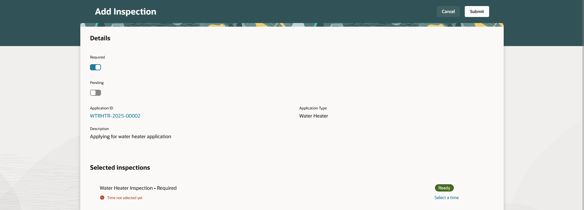

The Add Inspection request page for a single inspection can look like this when a time hasn't been selected yet:
Add Inspection page - partial page view showing Details and Selected inspections sections (1 of 2) Add Inspection page - partial page view showing Request section (2 of 2)
The scheduling link will display either Select a Time or Select a Date based on setup in the agency-level permit options, in the Scheduled Time Range section. In this example, you must click the Select a Time link to schedule the inspection because the inspection was setup with a Time Entry Method of Specific Time for the Schedule scheduling method. For more information, see Setting Up Agency-Level Options for Permits.
If you selected more than one inspection type, they are all displayed in a Selected Inspections list. The inspection's scheduling link will display Select a Time for any scheduling method as long as the Time Entry Method in the agency options isn't set to Date only. If any of the scheduling methods have the Time Entry Method set to Date only, then the link will display Select a Date, because only a date value is used (preferred date, ready-by date, or assignment date, when the setup uses the count assignment method for inspectors). For more information about the different scheduling methods that inspections can have, see Assigning Inspections and agency-level setup documentation.

  5. Select the check box next to each inspection type that you want to add.
  6. Click Continue to access the Add Inspection request page.
  7. Select values for these fields:
    Page Element
    Description
    Required
    Turn on the switch to make an inspection required.
    The Required option defaults to the inspection type setting on the Inspection Group Details page. If the inspection is outside of the inspection group or is an unannounced inspection, the setting defaults to not required.
    Public users can't change the Required setting for an inspection.
    Pending
    Turn on the switch to make this inspection a pending inspection on the inspection request page.
    Public users can't change the Pending setting for an inspection. For more information, see the "Working with Pending Inspections" section in this topic.
  8. Depending on agency-level setup, click the Select a Time or Select a Date link to request or schedule the inspection.
    Depending on the scheduling method set up for the inspection type, agency staff and applicants can enter times in the preferred date and time fields or ready-by date and time fields, or select a time. Depending on agency setup, only date fields or date and a time range may be available. See the section, "Selecting an Inspection Time" for more information.
  9. Click the Remove action menu item to remove inspection types that you don't want to include in your inspection request. At least 1 inspection type is required in the request.

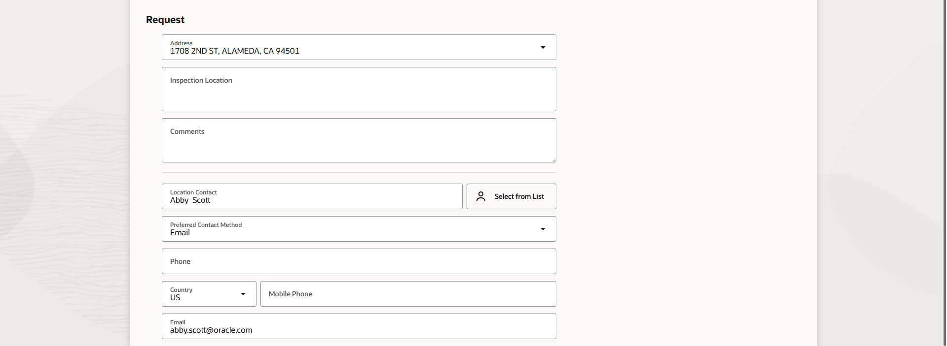

  10. In the Request section:
    • Enter or update the address, inspection location, comments, location contact, and location contact's contact information.
    • (Optional) Select a Reference Entity from the drop-down list.
      This option is only available depending on agency setup for reference entities and permits. Depending on setup, you may be able to further refine the inspection to indicate reference entity attributes. For more information, see the "Adding Reference Entities to Inspections" section in this topic.
  11. Click the Submit button.
