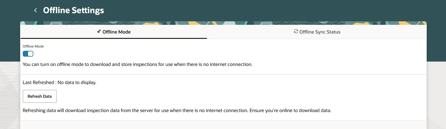

This example illustrates the Offline Settings page in a tablet form factor with the Offline Mode tab selected. The Offline Mode switch is turned on.
Use the offline settings to manage offline inspections in the Inspector Application. You may only see the icons without labels when viewing the page on a smaller mobile device.

Work with Offline Settings
Your agency determines whether you can work offline. If your agency supports offline mode, you can turn it on or off in the mobile application.
In Inspector Application, click the profile avatar after you sign in to view the menu. Select the Offline Settings menu item to open the Offline Settings page.
Here's how to work with offline settings on your mobile device:
| Page Element | Description |
Online Mode |
Turn on the switch to download and store inspections for use when an internet connection is disconnected. If offline mode is enabled, cached data is refreshed daily. |
Refresh Data |
Click this button to get a data refresh when the system next checks for updates. Ensure you're online to download data. |
