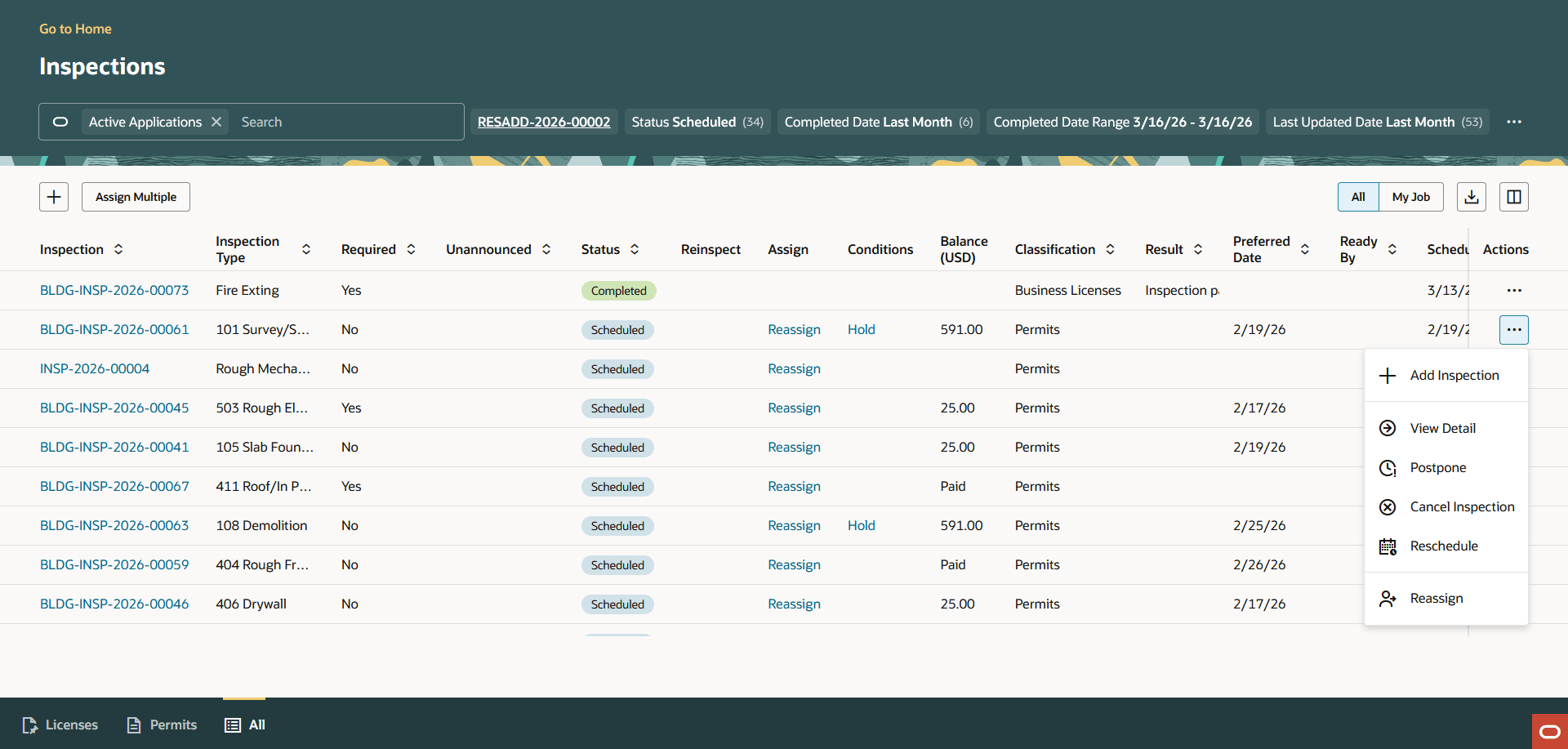

Performing Actions for Inspections
Let's take a look at the actions available on the list of inspections created within an agency.
You can access actions on the page or by clicking the three-dot actions icon in the Actions column:
Agency staff receive a warning when adding an inspection with prerequisite inspections that haven't passed or been corrected.
Page Element |
Description |
+ (Add) or Add Inspection |
Click to request inspections for an application. You can request an additional inspection for the permit associated with the inspection using the Actions menu in the inspection row. See also Requesting and Scheduling Inspections and Managing Scheduled Inspections. When the application status is Withdrawn or Completed, you will no longer be able to add new inspections. You can, however, add inspections for business licenses in a Completed status. If your agency supports pending inspections, the system prevents you from creating a new or duplicate inspection when an inspection of the same type is already pending. You can schedule the existing pending inspection. |
View Detail |
Click to view the inspection details on the Inspection Detail page. See Reviewing Inspection Details. |
Postpone Cancel Inspection Reschedule |
For information about canceling, rescheduling, and postponing inspections, see Rescheduling, Postponing, and Canceling Inspections. |
If a permit inspection was automatically created as a pending inspection, reinspection, or recurring inspection, agency staff can work with it from the Inspections list using the available actions for its status, such as viewing details, assigning, rescheduling, postponing, or canceling the inspection.
For information about assigning inspections, see the next section in this topic and Assigning Inspections.
