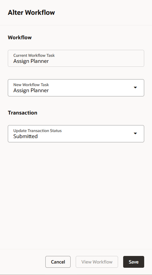

Altering Workflow
If needed, supervisors or administrators can change the workflow for a transaction type manually. This enables you to change the workflow step in case of system outage, user error, and so on.
Here's how to alter a workflow step manually:
Click the Options button and select Alter Workflow to display the Alter Workflow drawer page.
In the Workflow section, Select the desired workflow step from the New Workflow Task drop-down list.
In the Transaction section, select the proper status for the workflow step from the Update Transaction Status drop-down list.
Click Save.
If the alter request is not successful, supervisors have the option to redo the alter request and try again.
You can't alter a workflow task back to a pending status.

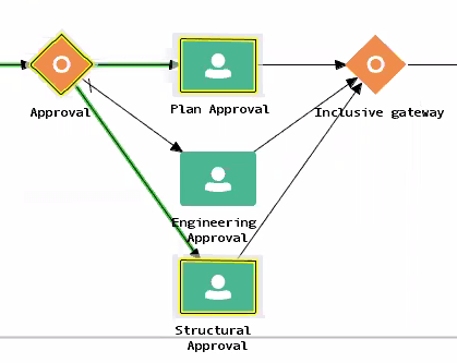

Click View Workflow if you need to review the steps and swimlanes in the underlying workflow process diagram as defined in Oracle Process Automation. This displays an image of the entire workflow process diagram you can view. Note that View Workflow is displayed in the classic user interface.
A workflow process definition may contain one or more parallel tasks. Here are considerations for parallel tasks:
They don't depend on each other to be completed.
They can be completed simultaneously.
The Alter Workflow action lists only the tasks that are outside the inclusive or parallel gateway specifically when the gateway is used in the process. Tasks within a parallel or inclusive gateway are not listed.
If you want to view the tasks within the parallel gateway, an administrator must navigate to the parallel or inclusive gateway start node in the underlying workflow definition.
For example, if a workflow process for a given transaction, requires a Plan Approval and a Structural Approval to occur in parallel, then Alter Workflow displays those tasks together.
This example illustrates a workflow process definition with parallel tasks.
