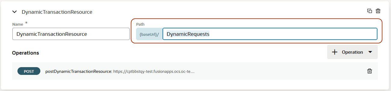

    When configuring a delivered connector or a custom connector, and you are specifying the base URL, adding the API endpoint to the base URL isn't recommended. Add the endpoint to the path at either the resource level or the operation level.
    OCI Process Automation adds a slash to the base URL automatically, which can cause issues with any additional URL items, such as query parameters. This applies to any endpoint but is always the case with the DynamicRequests end point, which doesn't support slashes.
    For example, when defining the base URL, don’t add the endpoint directly to the base URL path, like DynamicRequests in the following example:
    https://xxxxxxx.com:443/fscmRestApi/pscresources/11.13.18.05/dynamic/DynamicRequests
    Instead, add a resource to the connector, and add the endpoint URL to Path field for the resource or to the operation(s) within the resource. For example:

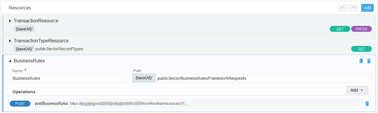

Step 11: Add the POST Operation for the Business Rules Request
This step describes how to configure integration with Oracle Permitting and Licensing by calling REST resources directly from workflow process definitions.
Generally, any REST API can be called from your workflow process definition. There are multiple REST API’s provided with the Oracle Permitting and Licensing offerings. The sample workflow models provided to get you started include only a handful of the integrations that could be configured, depending on your business requirements.
Each process definition has a set of connectors that you can view on the Integrations tab. In the sample workflow process definitions and documentation the each connector is separated to make it easier to view and describe. However, you may choose to combine all the individual connectors into a single connector.
This procedure outlines how you can configure additional integrations within process definitions to call Oracle Permitting and Licensing REST APIs to incorporate more data to drive your workflow process. This example demonstrates how to configure an integration with a Business Rules Framework API.
For more information on the Business Rules Framework, see Business Rules Framework Overview.
To set up an integration:
  1. Open the Transaction Connector.
  2. In the Resources box, click Add.
  3. Expand the added resource and enter these values:
    Page Element
    Description
    Value
    Name
    The name of the integration or connector. You can enter a custom name as needed.
    BusinessRules
    Path
    The name of the REST resource you intend to call.
    publicSectorBusinessRulesFrameworkRequests
    This example illustrates adding a Business Rules resource.
    Resource added to the transaction connector

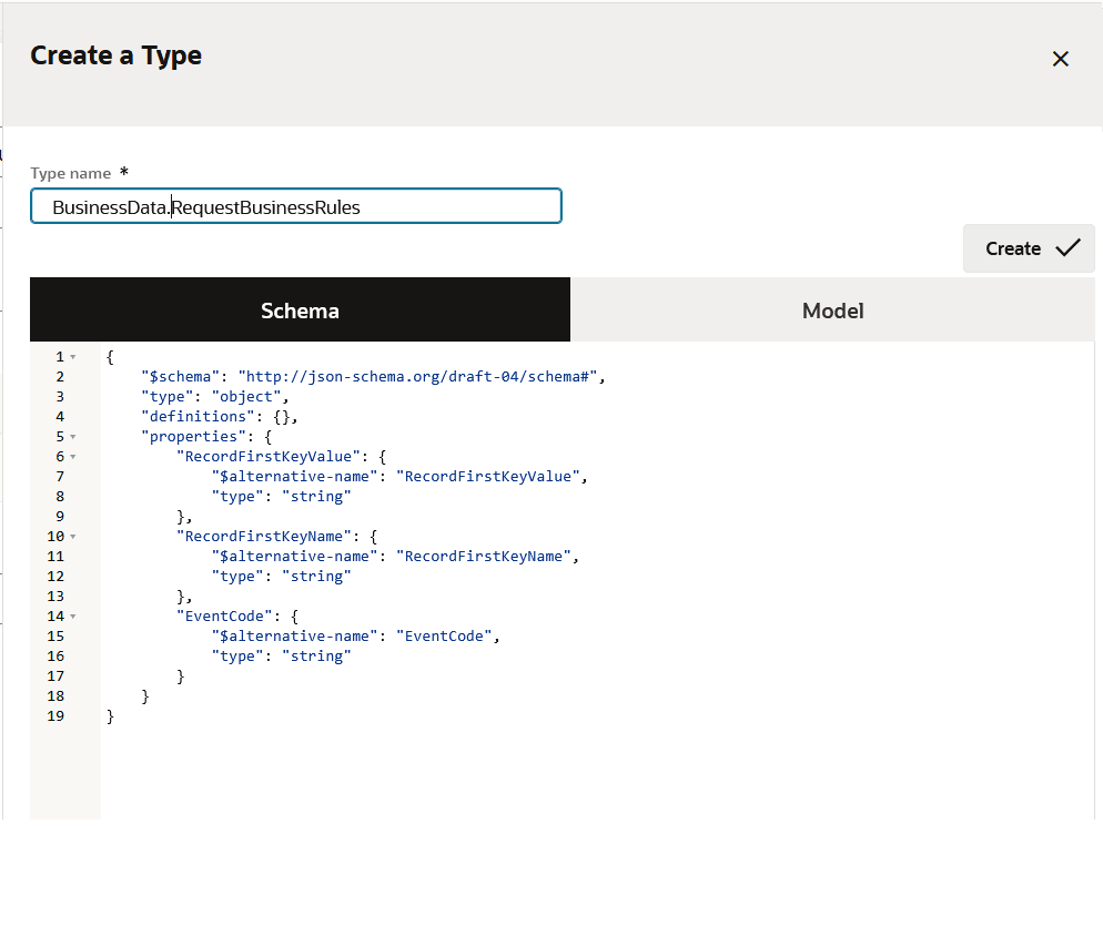

  7. Configure the JSON Request.
    1. In the Response and Request section, select the Request tab, and click Create business object under the Body field to open the Import Business Object from JSON dialog box.
    2. For Name enter a recognizable name for the request, such as RequestBusinessRules.
    3. In the Enter the JSON edit box, select Schema.
    4. Copy and paste this JSON:
          "$schema": "http://json-schema.org/draft-04/schema#",
          "type": "object",
          "definitions": {},
          "properties": {
              "RecordFirstKeyValue": {
                  "$alternative-name": "RecordFirstKeyValue",
                  "type": "string"
              "RecordFirstKeyName": {
                  "$alternative-name": "RecordFirstKeyName",
                  "type": "string"
              "EventCode": {
                  "$alternative-name": "EventCode",
                  "type": "string"
      This example illustrates the request JSON.
      Business rule request JSON
    5. Click Create.

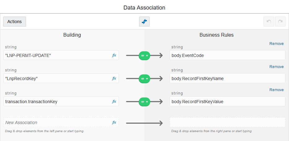

  12. Configure data associations.
    1. Select your integration task and select Open Data Association.
    2. On the Data Association page, select the Input tab.
    3. Map the following process definition data attributes to your Business Rules integration attributes, and click Apply and Save.
    Data Object
    Integration
    "LNP-PERMIT-UPDATE"
    or
    "PZ-PLANNING-UPDATE"
    Enter these values manually, depending on whether this process definition is being used for Permits or Planning and Zoning.
    body.EventCode
    "LnpRecordKey"
    Enter this value manually.
    body.RecordFirstKeyName
    transaction.transactionKey
    body.RecordFirstKeyValue
    This example illustrates that data associations between the transaction and the business rules integration.
    Associating business object data to integration attributes
