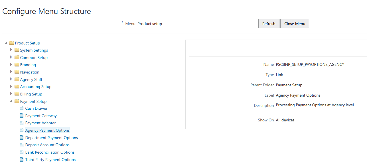

Selecting a Menu Item
When working with menu items, you have a graphical representation of the structure on the left-hand side of the page, showing all the menu folders and menu links within the menu structure.
Configure Menu Structure page
Select an item in the menu structure to view the details related to that menu item. Depending on the item selected, you have these options for configuring the menu.

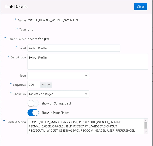

Configuring General Menu Item Properties
Menus contain menu items, which can be menu folders or menu links. Most of the properties you can view and set for menu folders and menu links are the same. Properties specific to a particular menu item type are noted below.
Link Details page
Page Elements
Description
Name
Identifies the name of the menu item, as it is identified within the application. You cannot change this value.
Type
Indicates the type of menu item, which can be: root folder, folder, or link.
Parent Folder
Indicates which root folder a menu folder or menu link exists within.
Applies only for menu folders and menu links, not root folders.
Feature Area
Indicates the feature area to which the link to a page belongs, if applicable, such as Permits.
Typically, this value is read-only and used internally.
Label
Identifies the menu item as it appears in the interface.
Description
Enter any descriptive text to help document the purpose of the menu item to other administrators.

Context Menu
The edit box appears only for menu items that display a menu, such as:
  • Switch Profile
  • Actions
This edit box enables you to manage content links that appear on a drop-down list for the UI widget.
Enter a comma-separated list of menu link names. For example:
PSCPBL_SETUP_MANAGEACCOUNT, PSCSECUTIL_WIDGET_SIGNIN, PSCNV_HEADER_ORACLE_HELP,
The menu link names added to the list appear in the list for that page control or widget.
