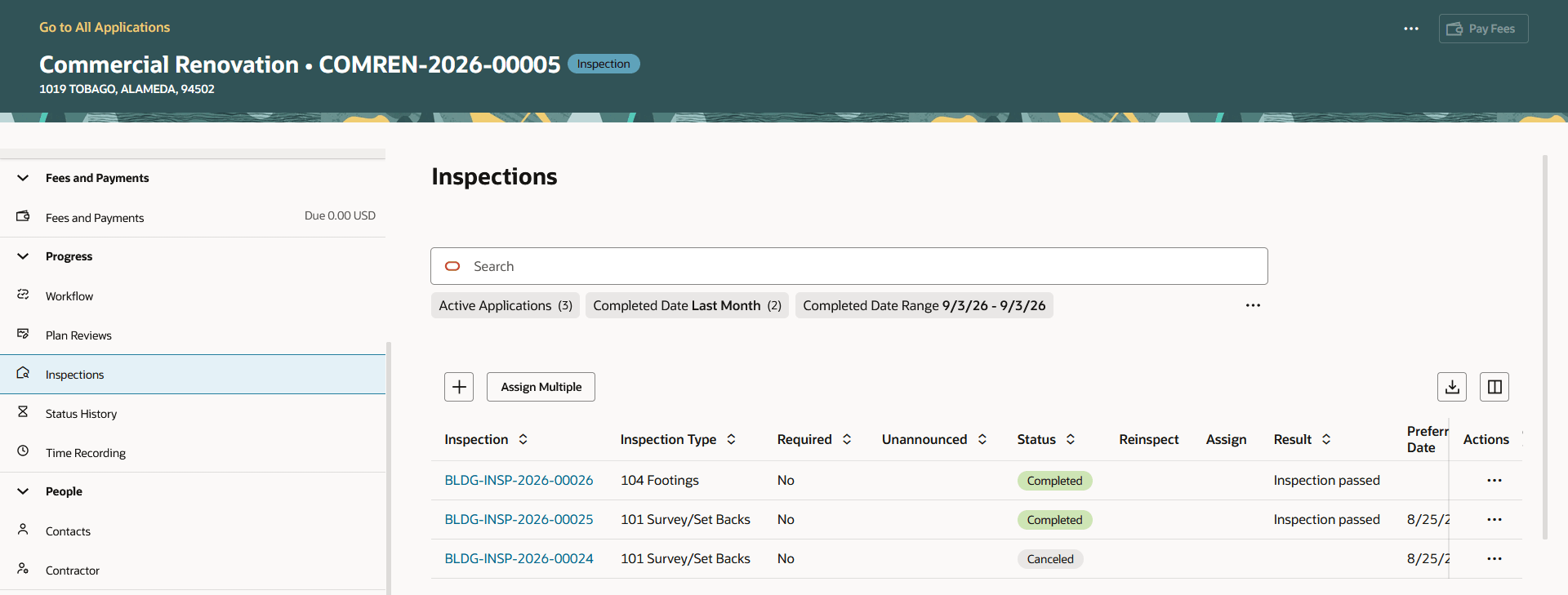

This example illustrates the Inspections page for a permit.
Permit-level Inspections page

  1. After you access the permit, expand the Progress section in the left navigation panel.
  2. Click the Inspections menu item in the left navigation panel to open the inspections list for the permit.
  3. On the permit's Inspections list page, use the search or filter for finding or viewing the inspections in the grid. Enter text in the search field or use delivered filters, such as the status or completed date range, when available.
