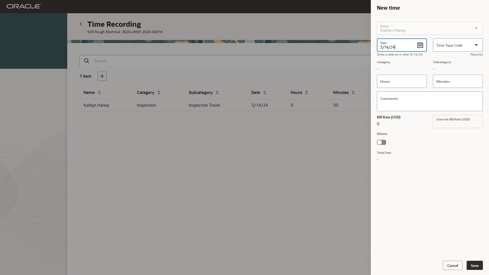

This example illustrates the Time Recording page with the New time drawer for entering a new time record.
Drawer that opens when adding a new time entry
Inspector Application - Time Recording page with the New time drawer
Click the Add (+) button on the Time Recording page or inspection details panel to add a new time entry. When you add a time entry on the New time drawer, you record the duration of the activity, whether the time is billable, and comments. You enter this information for each time entry:
Page Element
Description
Name
Select the inspector for the time entry.
Date
Enter the date for the time entry, such as when work was performed or travel occurred.
Time Type Code
Select the code for the type of time recorded from the drop-down list. For more information about time types, see Setting Up Time Entry Types.
Category and Subcategory
Displays the time entry type category and subcategory defined for the code. For example, the category and subcategory could be Inspection and Inspection Travel, respectively, depending on the agency setup.
Hours and Minutes
Enter the number of hours and minutes for the time type.
Comments
Enter comments for the time entry.
Bill Rate (USD) and Override Bill Rate (USD)
Displays the bill rate in U.S. dollars that was set up for the inspector's job title. For more information, see Defining Job Titles.
You can override the job title bill rate, if you have time recording management permissions.
Billable
Turn on the switch to indicate that this time entry is billable.
Total Fees
Displays the calculated fees.
When you save the time entry, it appears in the list of time records on the Time Recording page in the inspection details.
