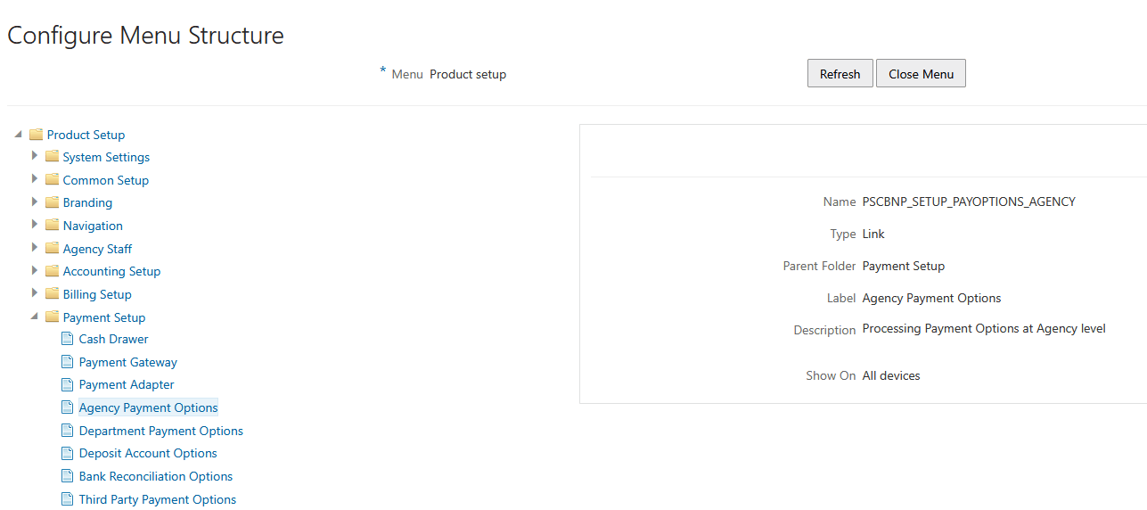

Selecting a Menu Item
When working with menu items, you have a graphical representation of the structure on the left-hand side of the page, showing all the menu folders and menu links within the menu structure.
Configure Menu Structure page
Select an item in the menu structure to view the details related to that menu item. Depending on the item selected, you have these options for configuring the menu.

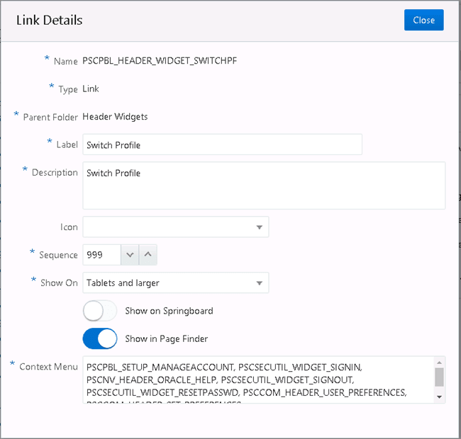

Configuring General Menu Item Properties
Menus contain menu items, which can be menu folders or menu links. Most of the properties you can view and set for menu folders and menu links are the same. Properties specific to a particular menu item type are noted below.
Link Details page
Page Elements
Description
Name
Identifies the name of the menu item, as it is identified within the application. You cannot change this value.
Type
Indicates the type of menu item, which can be: root folder, folder, or link.
Parent Folder
Indicates which root folder a menu folder or menu link exists within.
Applies only for menu folders and menu links, not root folders.
Feature Area
Indicates the feature area to which the link to a page belongs, if applicable, such as Permits.
Typically, this value is read-only and used internally.
Label
Identifies the menu item as it appears in the interface.
Description
Enter any descriptive text to help document the purpose of the menu item to other administrators.
Icon
Select an image from the drop-down list to display as an icon for the menu item.
This icon appears on these navigation features: the Navigator menu, the agency springboard, and the page finder. However, the icon may be a different size and display different color combinations depending on the navigation feature being used.
Sequence
In the case of multiple folders or menu links within a folder, set the order a menu item should appear in relation to the others. Any menu items sharing the same sequence number are arranged alphabetically. Otherwise, you can set the sequence: 0, 1, 2, 3, and so on.
The delivered menus use hundreds as sequence values for menus and tens for sequence values for menu items. For example, the eighth menu folder in the menu structure has a sequence value of 800, and the second menu link within that menu folder has a sequence value of 20.

Context Menu
The edit box appears only for menu items that display a menu, such as:
  • Switch Profile
  • Actions
This edit box enables you to manage content links that appear on a drop-down list for the UI widget.
Enter a comma-separated list of menu link names. For example:
PSCPBL_SETUP_MANAGEACCOUNT, PSCSECUTIL_WIDGET_SIGNIN, PSCNV_HEADER_ORACLE_HELP,
The menu link names added to the list appear in the list for that page control or widget.

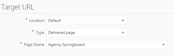

Configuring Target URL Properties
When you are adding a new link, you specify properties that control the link destination and how the link behaves.
This example illustrates the Target URL settings, which are described in the surrounding text.
Link Details page: Target URL properties
Page Element
Description
Location
Specify where the target content should display:
  • Default: The default target location depends on the target type.
    For a delivered page, the default location is determined by the target location defined for that page by Oracle development. Selecting, Default as the target location for a delivered page accepts the delivered behavior of that page. Selecting one of the other Location options below, explicitly overrides the delivered behavior.
    Typically, the application loads delivered pages using a partial page refresh, where only the content displayed in the content area is updated, leaving the same header and footer content. However, some pages open in a new window or modal window. Be sure to test the current behavior so you are aware of the default target location.
  • Replace Window: Replaces the current browser window with the target content, performing a full page refresh.
  • Modal Window: Displays the target link within a modal window. The user must interact with the modal window and dismiss it before returning to the main page.
    Not all sites support pages being displayed in modal windows. In such cases, the modal window is blank. If the target content is not supported for modal windows, select another option. Be sure to test this option prior to implementing it in your production system.
  • New Window: Displays the target content in a new browser window.
