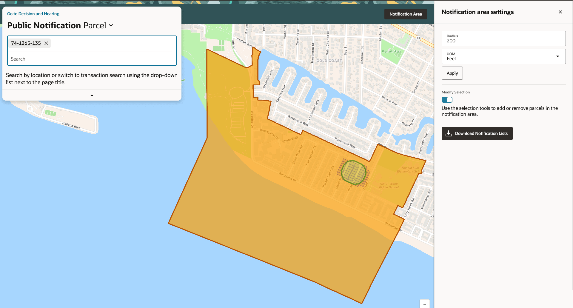

The following example illustrates the Public Notification page, where you can select properties, define a notification area around the selection, and download lists of addresses, parcels, owners, and neighborhood attributes from the notification area.

  3. Click the Notification Area button to open the Notification area settings drawer. Define the notification area by entering a buffer distance surrounding the selected properties.
    The fields for defining the notification area appear below the search field when a property is selected.
    Enter a number for the radius and select a unit of distance for the buffer area: Feet, Miles, Meters, or Kilometers.
    The fields for entering the distance appear below the search field as long as at least one property is selected.
  4. Click Apply.
    The notification area appears on the map. Visually, it appears as a bold green outline that follows the contours of the selected property at the specified buffer distance. If you selected multiple properties, there can be multiple notification areas. Parcels that are fully or partially within the notification area appear with a blue outline so you can see which parcels are included in the notification list. If the map is enabled to show neighborhood groups that are fully or partially within the notification area, they appear as a orange layer with a red outline.
